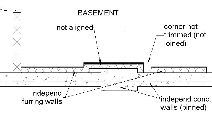

Good afternoon all!
Does anyone have created two walls with rigid insulation which wraps them in a plan view smoothly?
(Structure/ Wrap toggle does not help). Adding a separate wall does not work as well: when I disallow join, it is not what I want. When I allow join, it joins the concrete wall and “sinks” in it. Is there a predefined way to do this in Revit 2014?
Please share your experience.
Thank you.

Thank you for the advice. Now I seee that there is no "official" way to do it. I tried what you describe, but the wall, when I align it to the right  place, merges with the concrete wall and disappears inside it.

Wed, Sep 3, 2014 at 5:01:16 PM | Insulation layer wrapping the wall
glenlake
Joined: Sun, Mar 11, 2012
25 Posts
3.5 Stars: 3 Votes
You way is much better for these walls couldhave different phases, what is very important in many practices. I used both ways (in my sketch you see both approaches), and both failed. This video shows exactly what I want to have.
But I could not succeed in this operation from the beginning. What I am doing wrong?
Thank you for the video and for the advice. They inspired me.

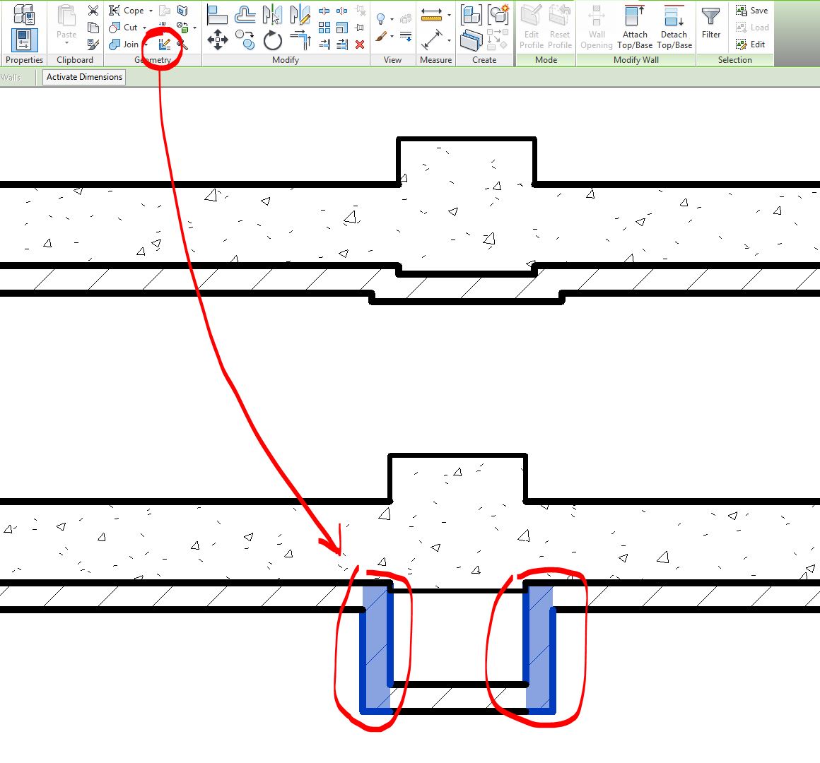

Ok, this is a little bit different than your original picture. Revit doesn’t like this condition (very short walls) too much, but you can try using Wall Joins tool and maximize the length of those short walls – see pic.

I've got it!
First, disallowed join of all the concrete walls, then placed the furring walls at the desired place (they were joined and looked nice), then dragged the thin conc. walls to the tick walls (they were still not joined), worked a little on somethhing else (it also might be a factor in such a wierd process), then went back to these walls and joined them with the Join tool.
But on he video it is much more simple!
Thank you all for help!
