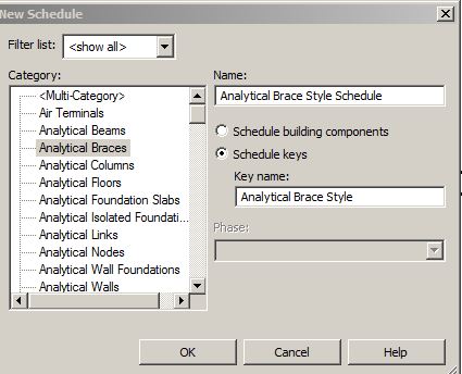

I am curious about this then. Dpes Revit have a material schedule you can create? I am not seeing one. I think that is our issue because we just want a text schedule that wasn't linked to anything so nothing would be deleted.
Tue, Sep 2, 2014 at 3:27:07 PM | Schedule Problems : Deletes modeled items when I delete blank fields
Revit has a material takeoff which is a schedule of materials that are used in a model.
If you just want dumb text which appears like a schedule, some users will create a schedule key in a category that they don't use in their model.  (For instance if you are architectural only, you might use one of the structural analysis categories.) Then they add schedule fields as needed.
Tue, Sep 2, 2014 at 3:44:47 PM | Schedule Problems : Deletes modeled items when I delete blank fields
ericlovell
Joined: Mon, May 10, 2010
14 Posts
Thank you very much. That helps a bunch
