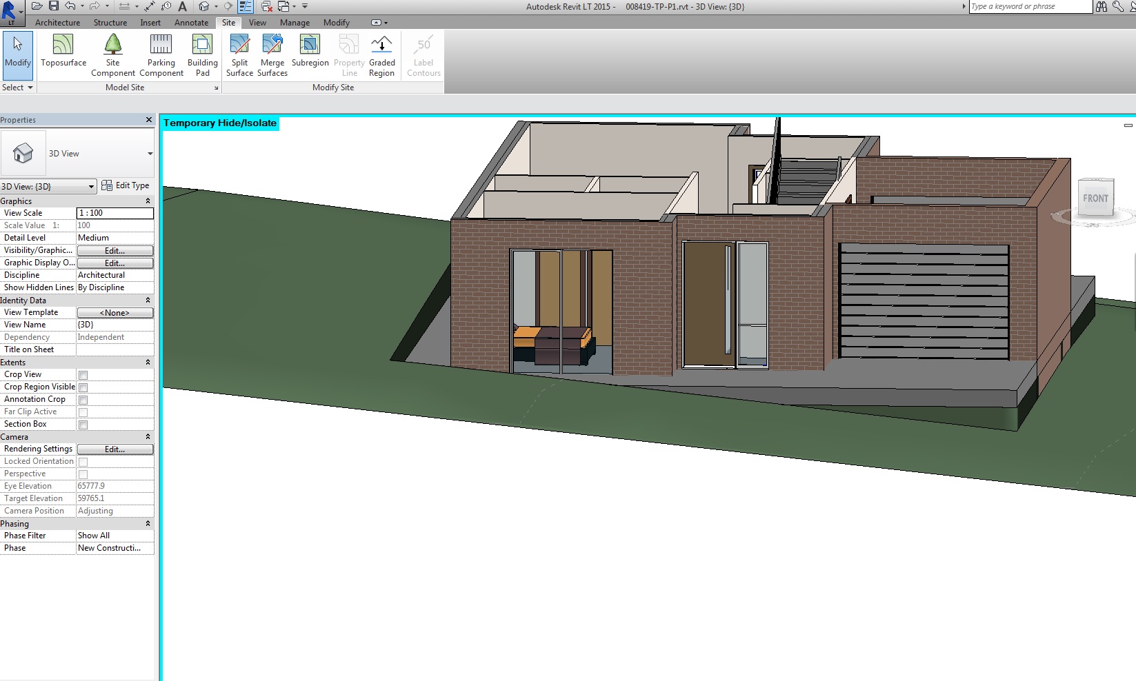

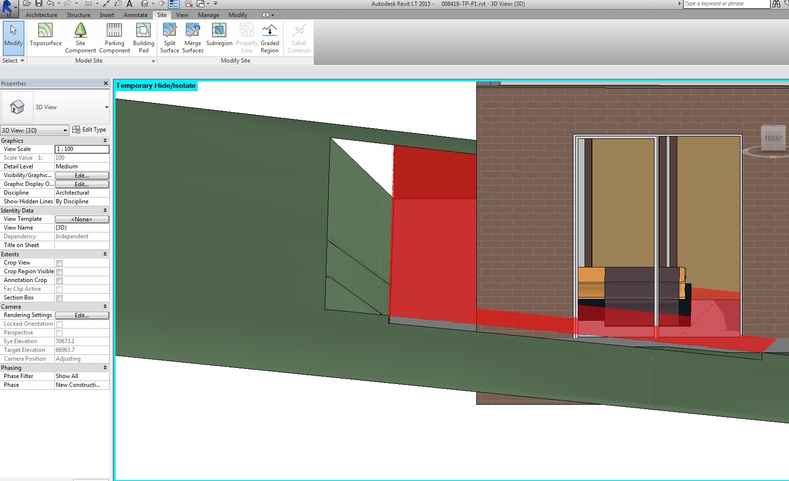

hey guys can you give the building pad a 45º batter say if I didnt want retaining walls. Cheers.

I am currently using the split surfaces tool to do them is this the best way?

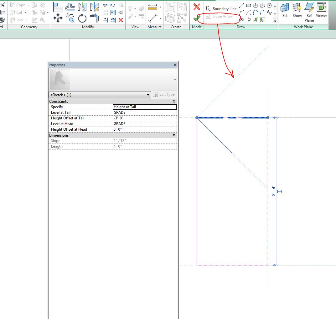

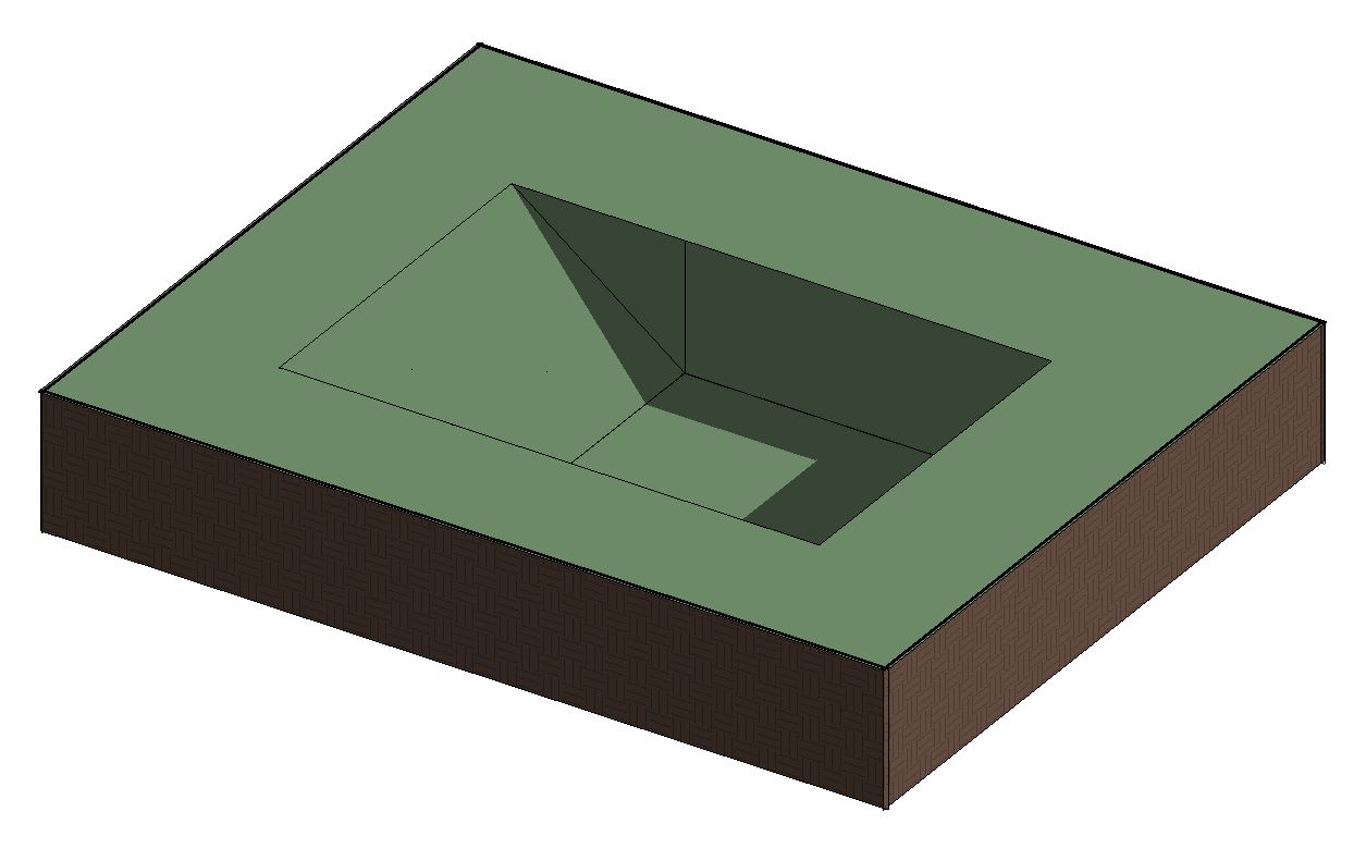

Sure. Use two pads, flat and angled with the slope arrow. Slope arrow can have a slope or tail and head heights.

ohh cheers. that works good if the block is flat but if its uneaven I have to use split?
