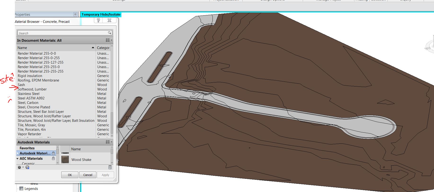

Started a new project. making a site topo. just realized that there is no Site-earth or site-grass materials in this particular project file. ie. I want to make a subregion of grass...
And if I go to a model that I know does have it, its there. but the new file isnt looking at the same materials list?.
Is there a reason this new file would not have all the materials? how am I looking at another material list (its a lot shorted by the way)
I thought there is only one...

Materials are file / project specific although you can export the materials to an external library then insert individual materials from that library into a different project. This is what you need to do.
You can also use 'Transfer Project Standards" to move all the materials from one project to another but you can't hand pick the ones you want. It's all or nothing.
