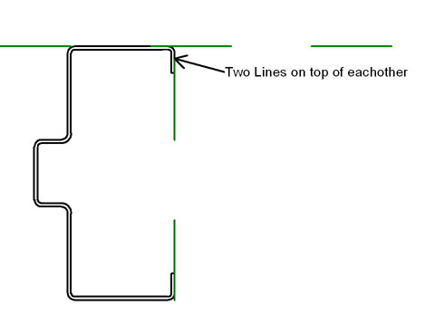

Here's my problem. I am trying to create a new door family, one that has a standard 4 3/4" metal frame. I created a profile but everytime I place it in the family as a sweep REVIT tels me it can't create the sweep and gives me an ID error. I am attaching the profile that I created and ask anyone if they can tell me how to get it to work. TIA

Your Profile Family has overlapping lines. That's probably what's causing the problem.

That was it. Thanks for the help!
