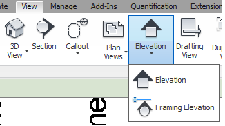

I don't know what you mean.  The elevation pulldown on the ribbon is as shown below.

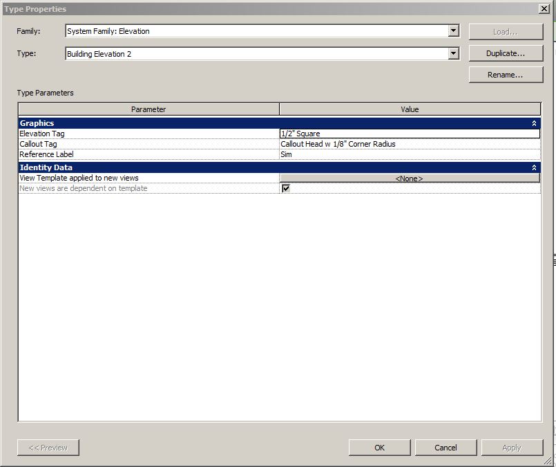

If you mean the properties pulldown, then you should see the newly created types as my duplicated building elevation 2 shows.  If you don't see it then you didn't create any new types.

Ooops - here is the corrected first image.

I think you are showing us the properties for the callout family - not the elevation view.  Otherwise, someone renamed your stock elevations.... whay else would one be called "Floor Plan Level 1"? << No such elevation
When you edit the view type, you will see this menu and this is where you create your types.  NOT in the callout family - that is used in this type definition.
