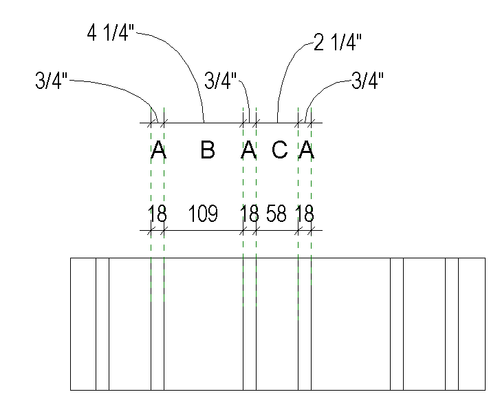

I found this pattern when I searched for board and batten patterns under RevitCity downloads.  It is a nice pattern, however I would like to change the dimensions so that the center of the batten is every 2 feet.  Does anyone know how to do this?
I am using Revit 2013

The pattern looks like the attached image. What would you like the A, B, C dimensions to be ??
