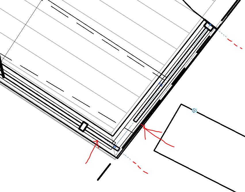

Got two curtain walls forming a corner window. had to adjust the underlying wall. and when I stretched the C Wall to match the new length the glass panels didnt change with it. cant figure out what I did, or how to get the glass to stick with the curtain wall line...
Sat, Aug 16, 2014 at 8:20:44 AM | panels dont update on Curtain wall length
Not enough information.
Is this CW an automatic one?   In other words, are the panels and mullions as well as the spacings set in the description?
Where are your grids for this CW?  Look at it in elevation.
It may be that you just have to put a panel in there.
Also - does this CW have a sketch on it?
