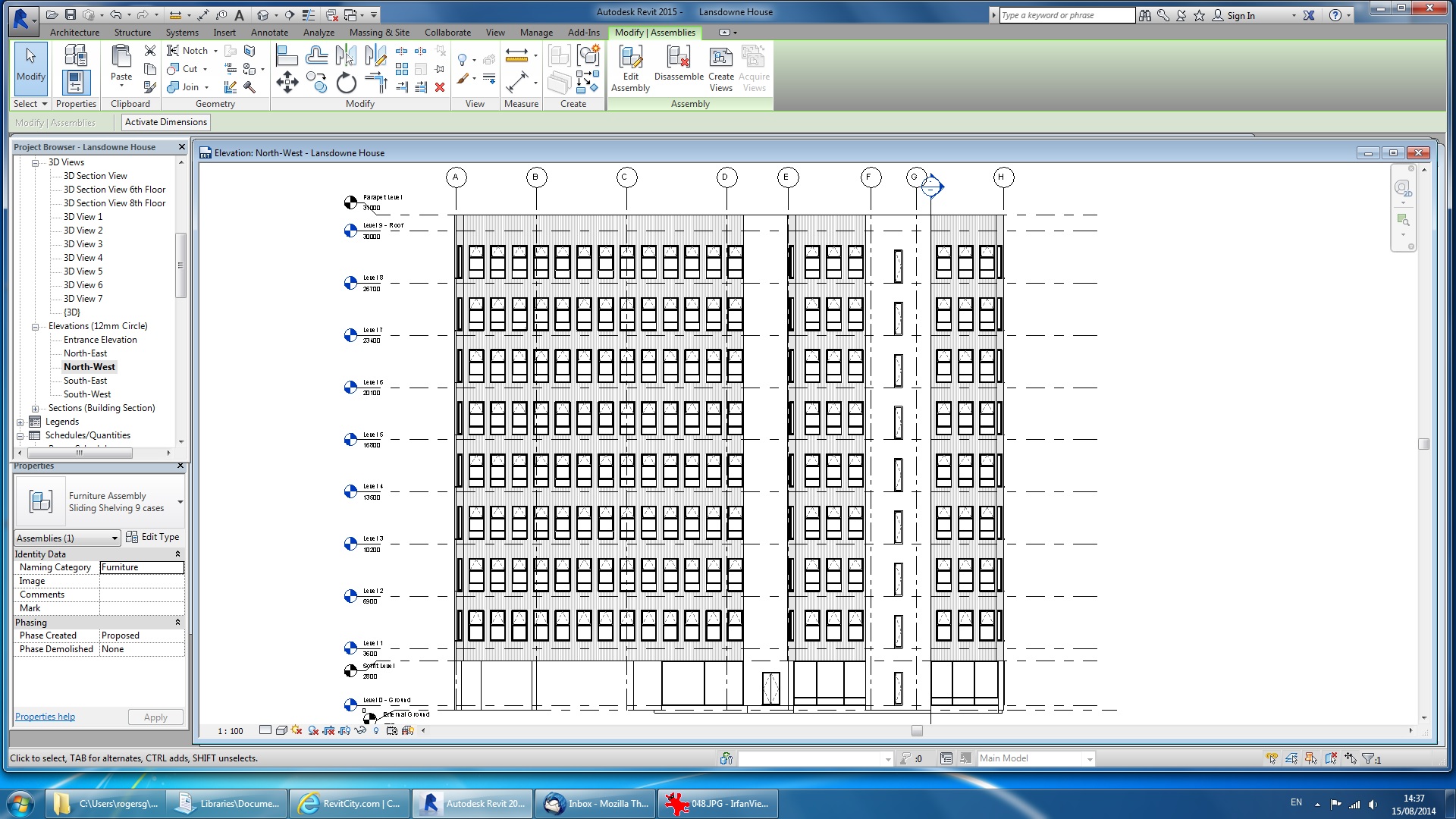

Be patient here.... your process is somehow incorrect and it is hard for us to ferret this out.  Your most likely problem is incorrectly made views.This is not CAD.  All floor plans should be associated with levels.  You can't just copy a floor plan and call it a new level name.

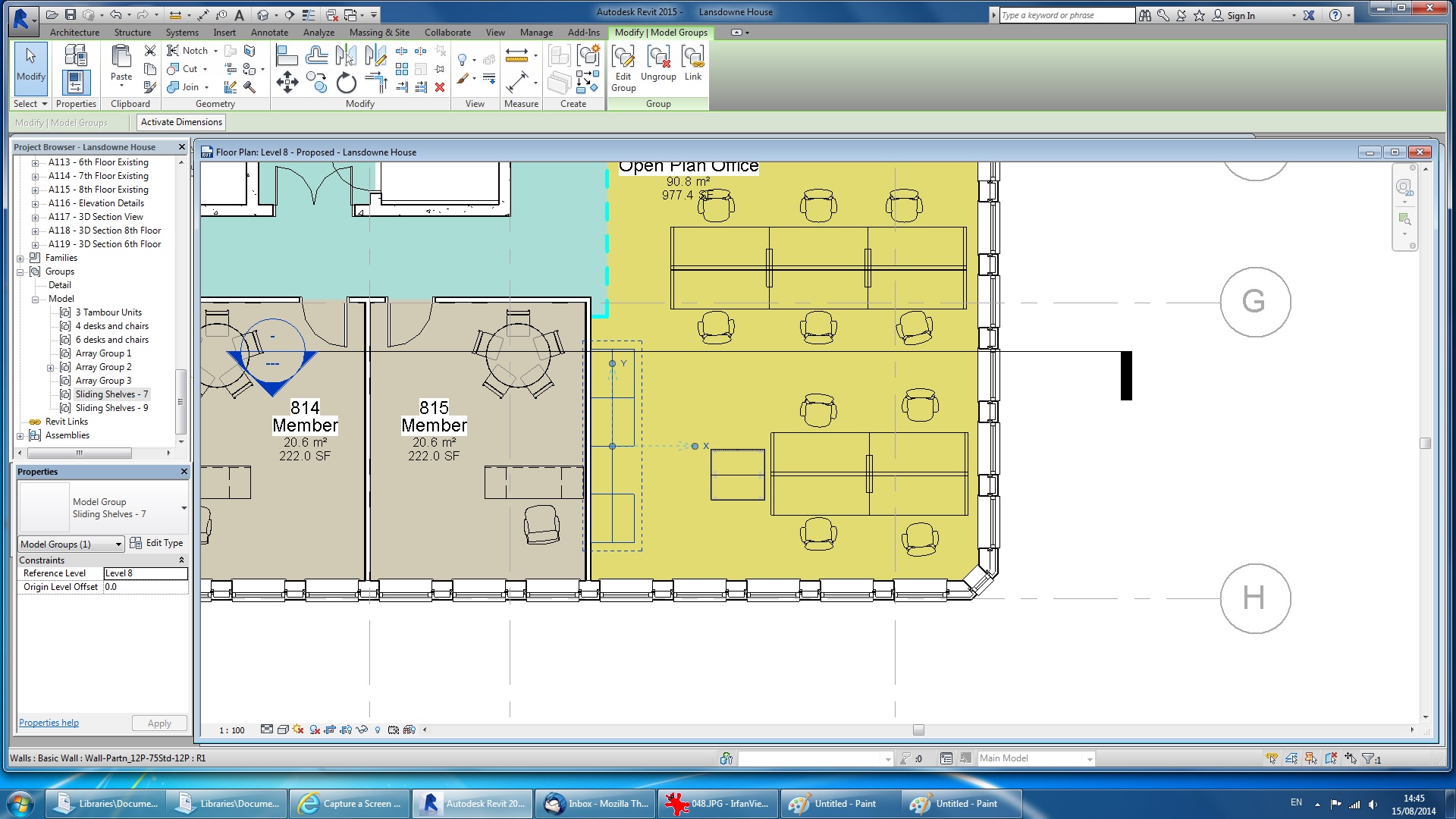

Goto an elevation view.  What color are your elevation level heads.  THEY MUST BE BLUE.  If not, then come back and we will help furthur.  If they are blue, then come back with a screen capture of your elevation view and a screen capture of your group properties.

Here are the screen shots. Is this the info you require? Thanks
