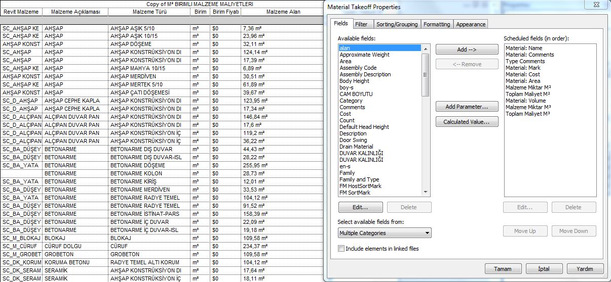

Hi,I am trying to calculate different calculations according to "Material: Mark". For example, i have 2 materials whose marks are "" and "". I want it to calculate ParameterA*ParameterB if mark is and vice versa.But when i click OK, it says "m² is not a valid schedule field." Here is my IF statement:      IF (Material: Mark = m², "ParameterA*ParameterB", "ParameterC*ParameterD")             Any suggestion?

 I did read actually. Still couldn't figure it out. My condition is being m² or being m³. But it says, "the following is not a valid schedule field : m²"

Look again at the help.  What type of parameter is your mark?  I am assuming it is text.... whell then when you look at the Help, you see that strings (text) have to be enclosed in "XXXX".
In addition, Revit doesn't understand mixed case.  So do you really want M2 and M3 instead of what you are trying to do?

Thank you very much for your patience Smile Yes, it is text. But it doesn't matter if it is m³ or ABC. It is still saying "not valid schedule field."  If it is not too much to ask; could you please write it for me to try? What i want is, if "Material: Mark" is "m²", it should multiply "Malzeme Miktar M²" and "Material: Cost". If it is not "m²" (or if it is "m³"), it should multiply "Malzeme Miktar M³" and "Material: Cost".  Thanks by now.

Your units have to be correct!  Text is text and must have " quotes" around it!  What unit type is material mark?  A material Mark is text!  In addition, can not exist in Revit as text or as a number!!!!
Wed, Aug 13, 2014 at 10:13:19 AM | If Statement in Schedules' Calculated Value
In addition, You can't multiply text!
If (Material = "ABC", Number1* Number2, Number3)  <<< Numbers are numbers - Material is text.

Oh no no. Multiply ones are already regular numbers. I misunderstood you, sorry. I suppose i have to duplicate material cost too ( i forgot this, yeap) as numbers and change special characters in material mark. Thanks for your help! (i am trying to read, reply and understand while i am on my phone and in a crowded bus Smile i accidently pressed and reported your previous message as offensive. Sorry about that too. Smile )   Gosh what a terrible day!
