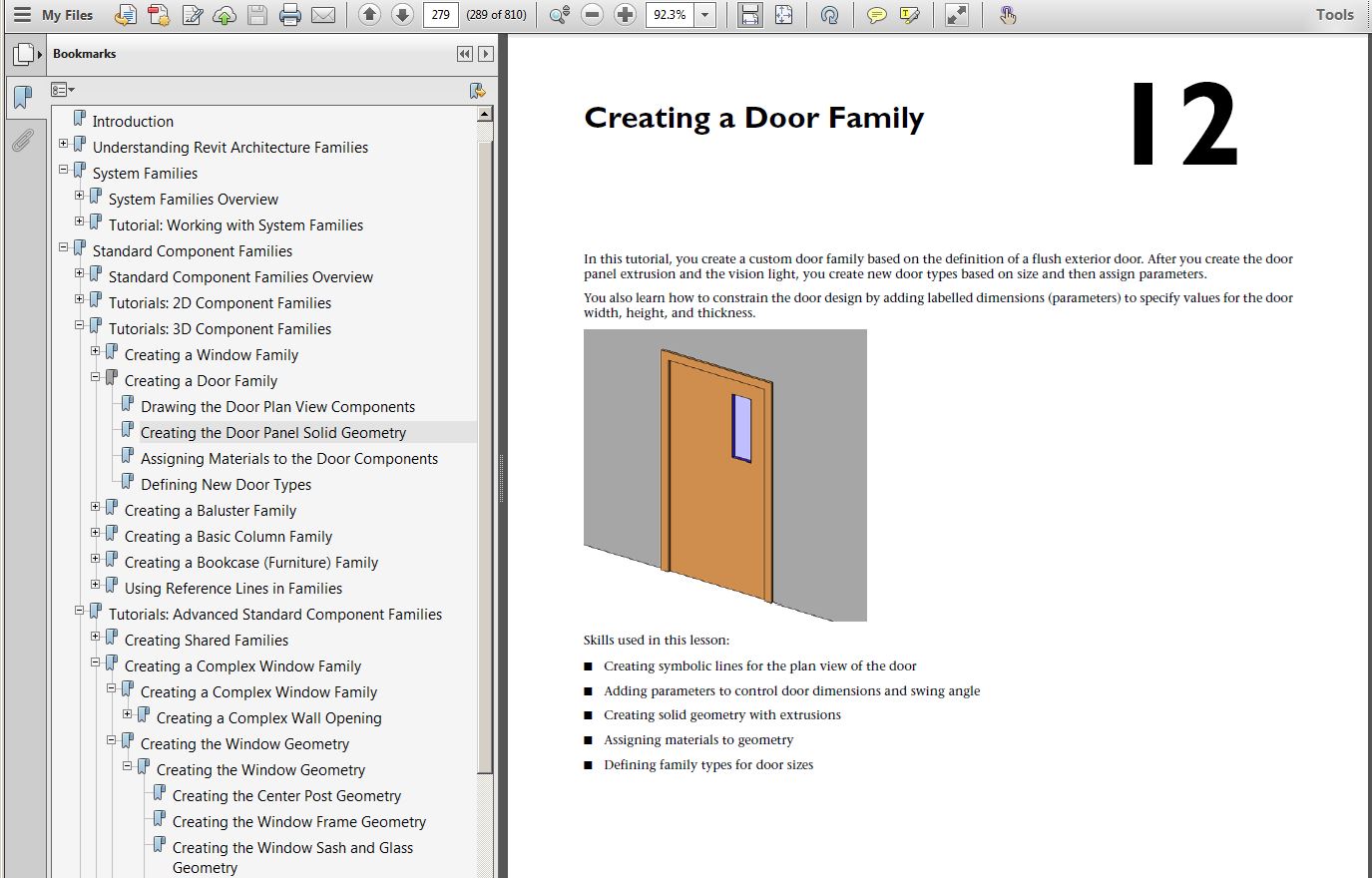

i am searching almost a week to find a good post or video to understand how to create a master door rtype with option of ' glass' or louver etc. please i need a help, I have a metal door simply i want to add glass and louver options to it so i do not need to create again and again, i appriaciate if you experts comment and help me
Tue, Aug 12, 2014 at 8:56:58 AM | How to add multible door types to master door Please Help!!!
You can do this or you can buy an all in one family.... but I don't recommend it.  It is far easier to have multiple families here and you don't "have to create again and again".
To create multiple panel types in one family, use a nested family for the panel and set which nested type you use in the door family by using parameters.  This is a complicated process so you will be spending time learning how to do this.  Start by downloading the "families guide" from the autodesk site.

Thanks for reply, but i need a fast process , is there any video or a post can teach clearly, some of the posts i found is not with a clear speech typo !
Tue, Aug 12, 2014 at 9:30:38 AM | How to add multible door types to master door Please Help!!!
The fast process is to use one working well door family, copy that to a new name and revise it to add lites, then copy that family to a new name to add louver.

Sorrry maybe you misunderstood me, but thanks for your help , i checked almost everyday revit family topics and parameters, most of the posts are not working for me, i need simple and clean explanation if i can have where posted before . Simple ; One Host door with louver and glass options thats all, if you know a post that teaches please respond it otherwise not helping at all.
Tue, Aug 12, 2014 at 12:49:55 PM | How to add multible door types to master door Please Help!!!
Reread my very first post!!!!
Here is what is in that guide:

thats perfect , thanks ))
