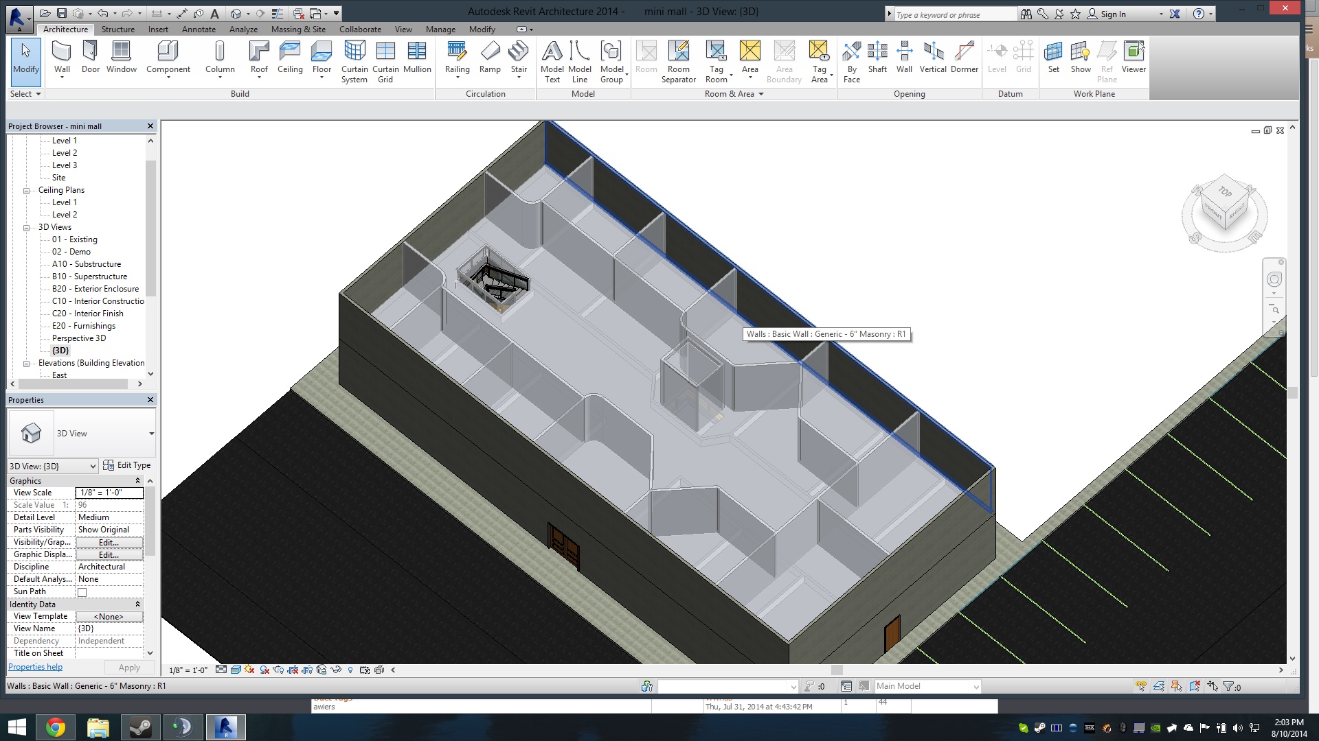

Firstly, in 3d mode everything in my level 2 floor plan is transparent except for my exterior walls.

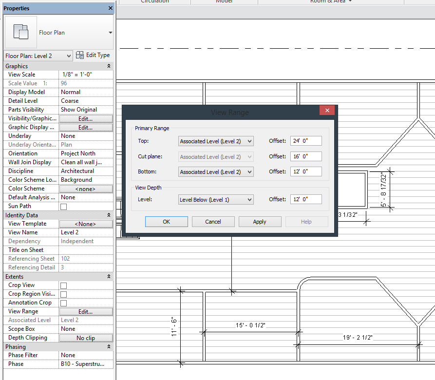

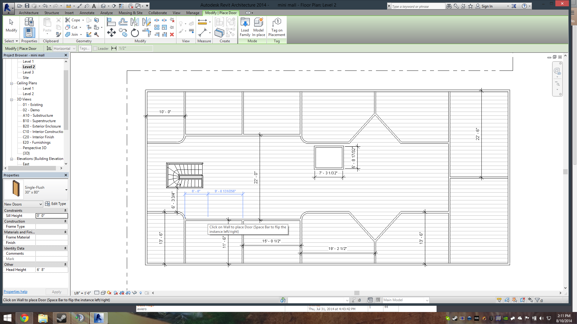

Secondly, in my level 2 floor plan it seems like i am not able to view the doors that i am adding to the walls.
Are there any ways to fix these issues im having. I also attached my view range and properites for the second level.

3d view - VG issue or filters or phases.
Plan view - look at your cut plane - it's at 16' !!!! Set it to cut through your doors.

Thanks a lot! This solved my problem 100% Your a great help.
