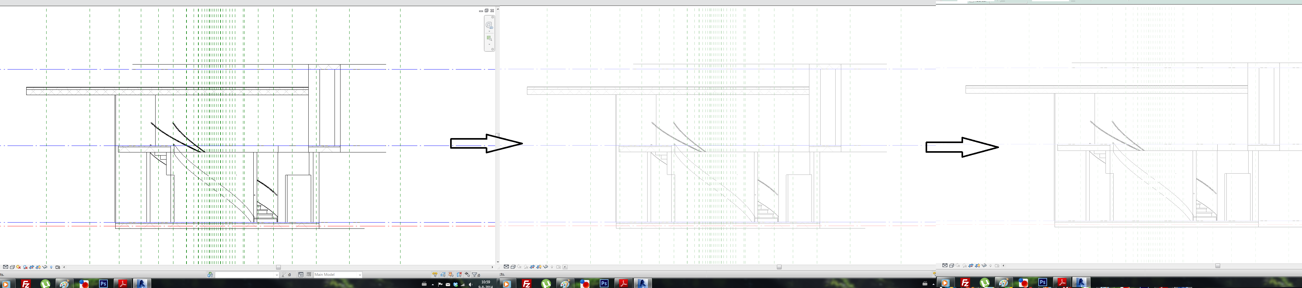

Hey guys,
How come that if I work with reference lines, my lines get weaker every time I choose a function.
See attachment with 3 screens:
1. normal view
2. when chosen component (inplace)
3. when chosen VOID (blend)
I need to see the lines, to create an exact VOID shape.

Sun, Aug 10, 2014 at 3:30:55 PM | Visibility reference planes
You have way too many reference lines.
The other components or lines will ghost somewhat is typical.
Are you nesting these?
