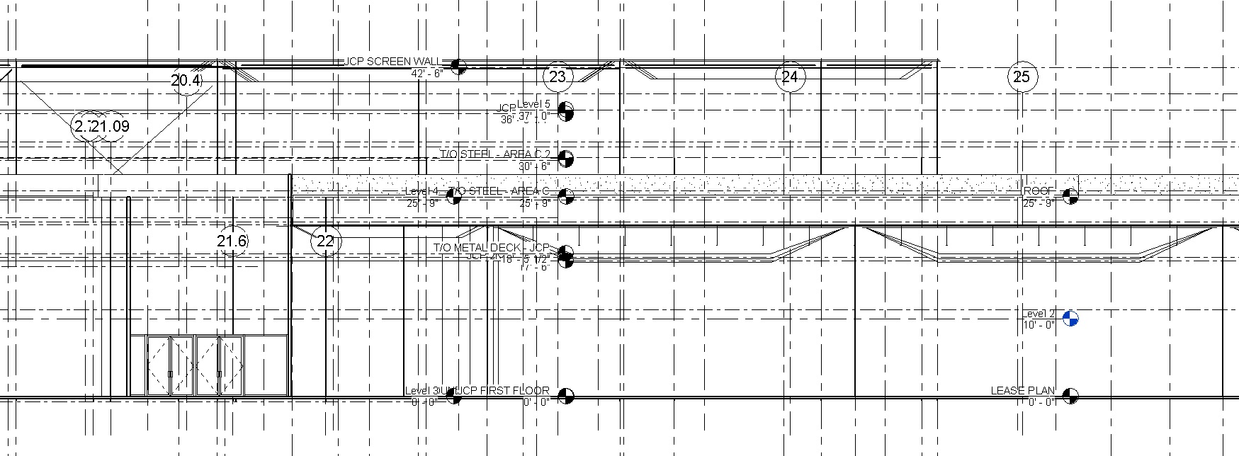

I'm working with a model provided by a consultant. The amount of levels seems extreme and I'm having difficulty selecting and finding the ones I need. (I want to clean out the redundant levels- hope to pin the levels I want and delete the rest) Do levels have a unit ID that I could use to select them? Or does anybody have experience cleaning up a model in this situation?
Could be in either 2014/15 Architecture.
Thanks in advance!

Wed, Aug 6, 2014 at 4:11:21 PM | Selecting/Finding Specific Level
You may find that deleting them causes problems with hosted elements.
If you are using worksets, simple put them on a workset that is normally off.  I suggest you DON'T pin the levels.  Excessive pins and locks create other problems.

I had considered the hosted elements, but I need to be able to find the levels I want to keep first so I can move the hosted elements. We are not using worksets. And I wasn't planning on keeping the levels pinned- just so that I could remove the un-needed elements.
Once I am able to clean up the levels this model will be linked into another and the levels copy/monitored. As it is now I can't find the levels to copy/monitor so I thought cleaning up the model would be the first step.
Do levels not have a unit ID to select them by?

Thu, Aug 7, 2014 at 8:33:09 AM | Selecting/Finding Specific Level
I don't understand what you mean by you can't find the levels.  Goto an elevation or section and look.  As far as determining what to keep - how would we or Revit know?  Levels without associated plans are black targets, otherwise they are blue.

I mean there are so many on top of each other, as well as only in certain sections of the model, that I'm having difficulty determining what is on each level. I can see all of the levels listed if I go to create a floor plan by level. But for example, I can't find Level 1 specifically because at 0'-0" there is JCP First Floor, Lease Plan, Level 3, Ground Floor Area C, T/O Footing Area C and more. You can see what I mean in the image attached.
I need to clean up the model so that there are not levels for each store but standard levels for the entire shopping center.

Thu, Aug 7, 2014 at 8:57:04 AM | Selecting/Finding Specific Level
Start by turning off everything in VG except levels.  Now start picking and deleting.
