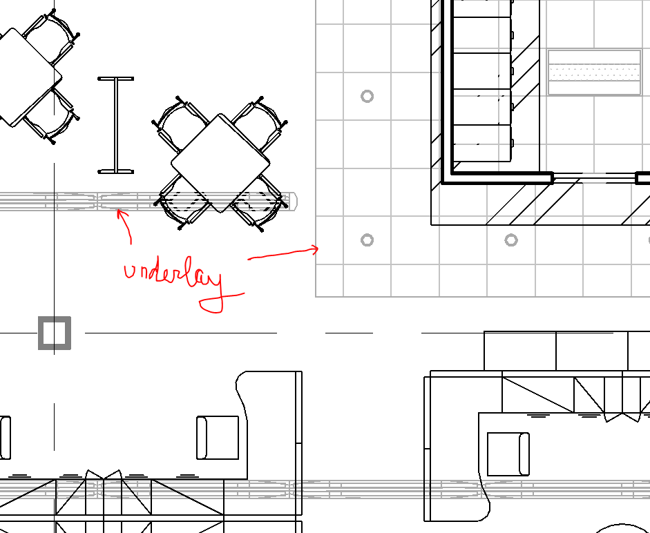

So my firm is unfortunately still using ACAD along with Revit and there is a need to have a floor plan exported into dwg format with the reflected ceiling underlay in the ACAD plan as one dwg. Is there a way to do this? I have tried everything that I know of and it will not export the RCP underlay with the rest of the floor plan even though the underlay is turned on correctly in the view I am exporting.
Any help is appreciated.....

Funny thing is I can open a RCP and turn on the Floor plan as an underlay and it exports it just fine. Why not the other way around??

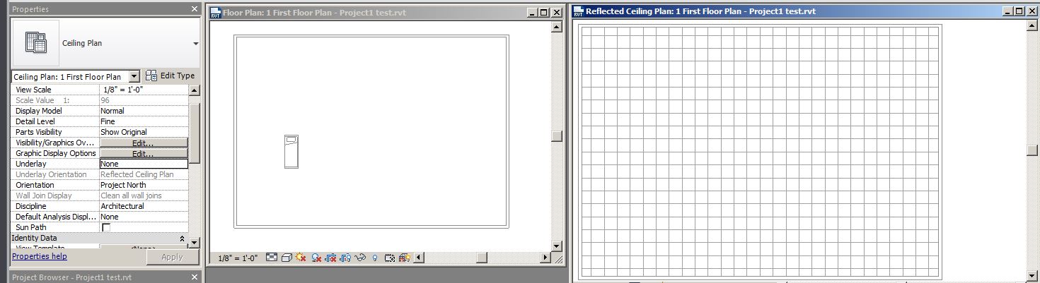

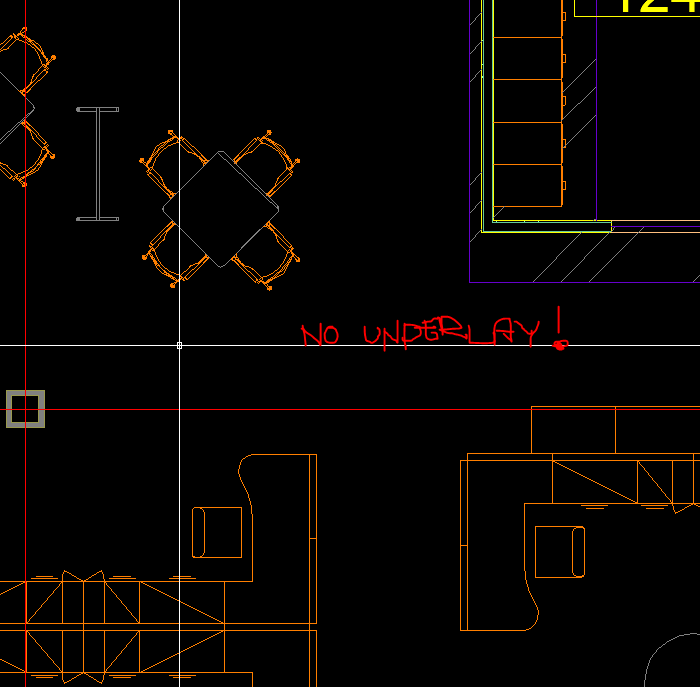

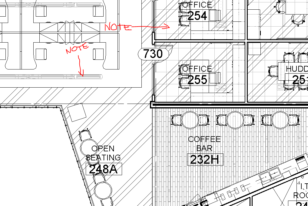

Thanks for that, but I know how the underlays work in general. You are absolutley correct in saying that I am underlaying the FIRST FLOOR, not the FIRST FLOOR RCP. However I am underlaying the FIRST FLOOR level from the RCP perspective when using the Reflected Ceiling Plan underlay orientation setting which in turn underlays the RCP information. I just so happen to say that by doing this I am technically underlaying my RCP into my Floor Plan.
Now that all being said, my problem is that I cannot get the FIRST FLOOR plan in the Reflected Ceiling Plan underlay orientation to export with the floor plan. In the images I uploaded of screenshots you can see its there on the screen the way I want it to export but when actually doing the export the ceiling items do not come through like the view shows. Its weird how i can open a RCP and underlay the FIRST FLOOR plan in Floor Plan underlay orientation into it and then export and everything comes through fine. The problem with that is I cannot get the foundations easily with just the view range since the native RCP's view is oriented from bottom to top whereas the floor plan orientation of underlay is top to bottom.
I don't fully accept it yet but I am starting to think that what I am trying to do, albeit it seeming like a very simple concept, is not achievable in one single export. I know I can export the RCP and floor plans seperate and then combine them into one dwg manually but I really do not want to do that.
I cannot find anything about this topic anywhere on the good ole www either. That suprises me that more people wouldn't have the same need as they work with outside consultants and such. Maybe I need to put it on an official wish list for Autodesk maybe....

I do not have a problem doing it that way either. My problem is the opposite. starting from a floor plan and using a RCP underlay orientation. Starting from a RCP and underlaying the floor plan works fine but has the limitation of not being able to include the foundation items.
