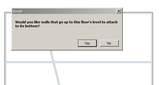

I have drawn all my walls with the top constraint being the level of the floor above. However I want the walls to attach to the underside of the floor rather than the topside of the floor as they currently do. Is there a quick way to edit all the walls or do I have to go through them one by one and use the attach top/base tool?

You should be able to edit the floor above (must be a change - you can always change again if need be) and you will see this message.
