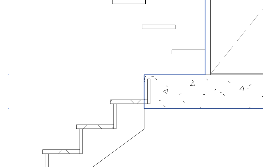

Hello,
I am struggling to find out, how to make nosing on the flooring edge.
Please find the picture attached.
Thanks in advance.

You could place a floor edge sweep there.
