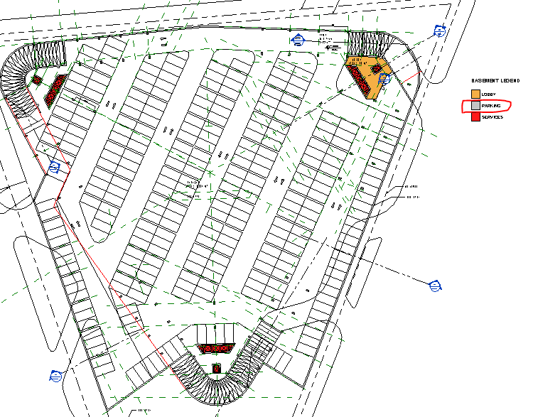

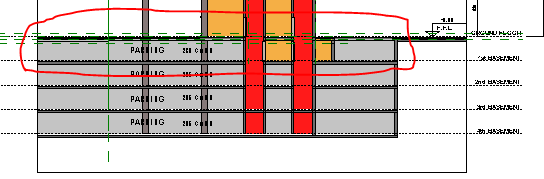

Wonder, why color fill, in parking space appear in section, and did not appear in plan,
when  created at first time it used to..
any one know how to solve it...?

The plan view shows the 'surface pattern' and the section shows the 'cut pattern' of the 'material'. I'd start by looking at the 'material' of the concrete. Try also going from hidden line to shaded mode etc.
