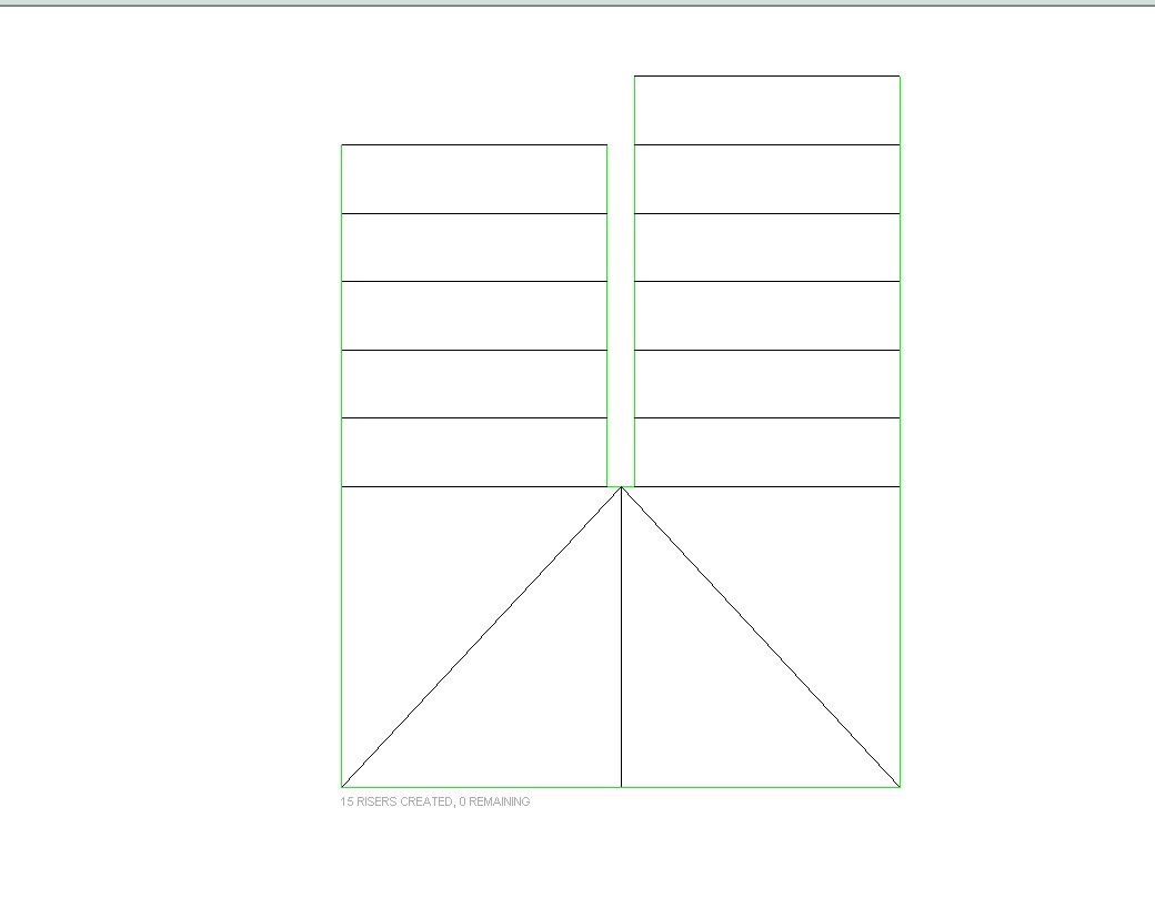

Hey guys whats the easiest way to create the stairs below. I read on some previous posts about winders but I am still unable to do it. Thanks in advanced.
I have just drawn in the winders in this case.

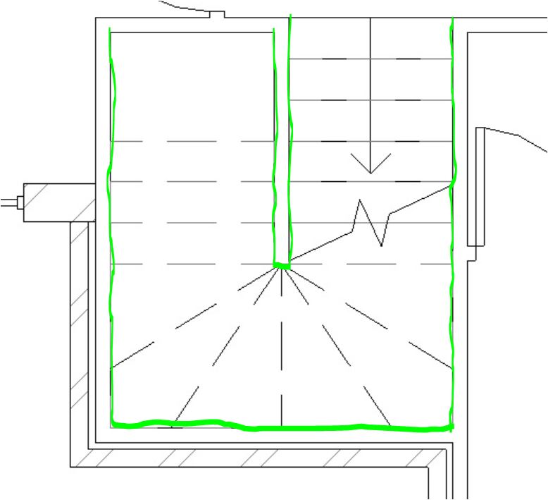

You can use stair by sketch
-creat\stair\stair by sketch
-cleck riser/then draw one by one, you can use offset or copy
-the cleck boudary and draw it as shown in attachment (green)
hope this will help you

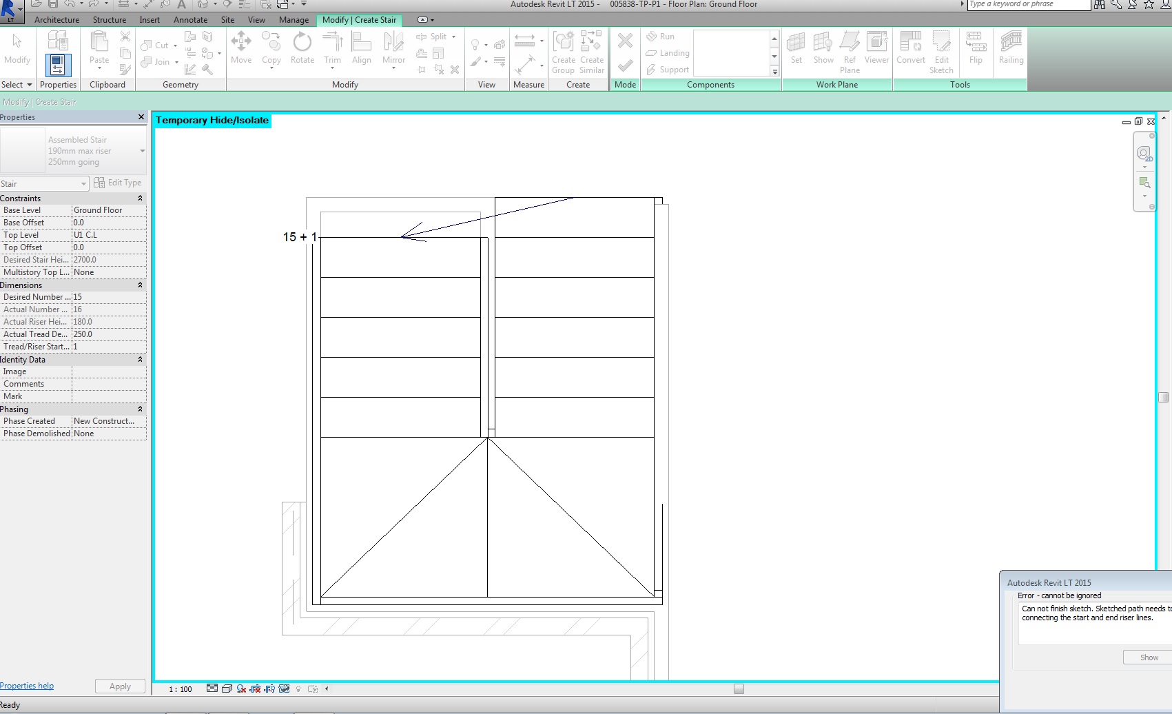

I tried and I get this error...
Can not finish sketch. Sketched path needs to pass through all riser lines, connecting the start and end riser lines.

Check, my be there is risers overlapping each other, try to expand the boundary to cover all risers

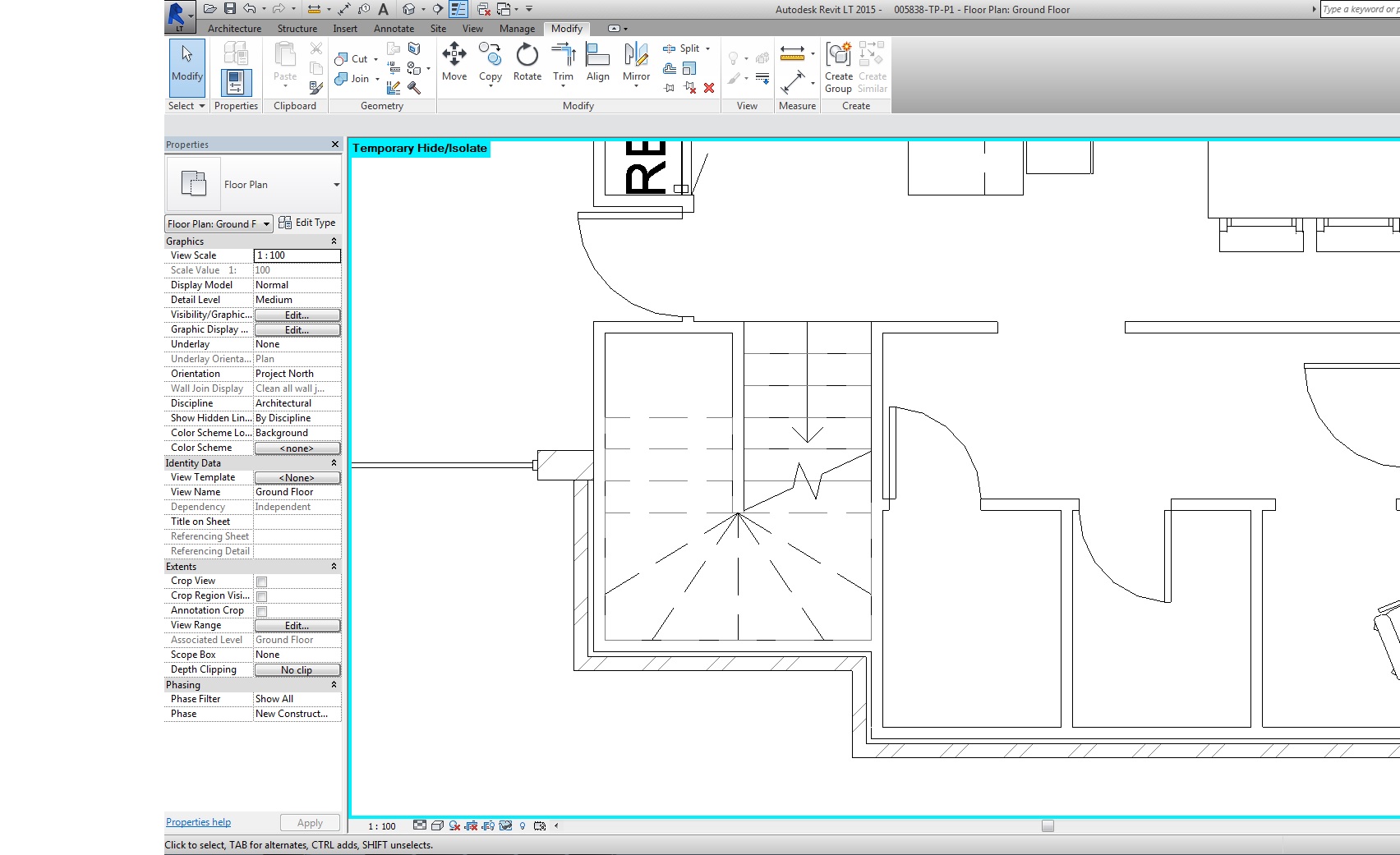

I did it again and says same thing but had this. Tried few things but couldnt get it working.

Try to it make in a new project revit file, and then copy it to your model

I didnt draw the stair path that was the problem thanks heaps for your help!
