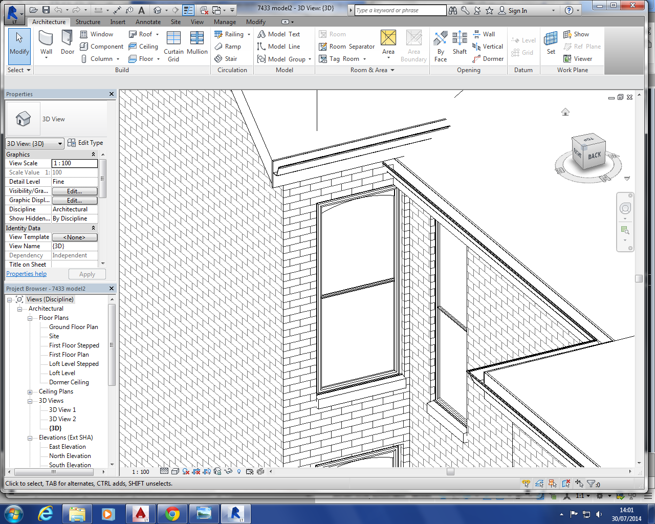

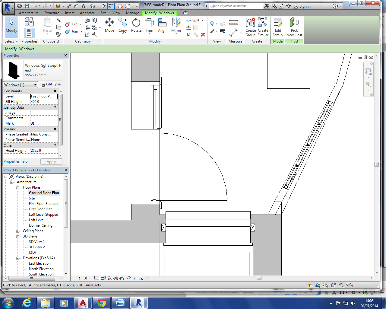

It is the Windows_Sgl_Swept_Head stock family that I have modified to have a larger cill.
Attached is an image of the ground floor where it is working and a 3D view showing where it is on the first floor.
