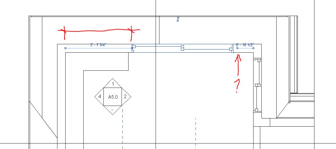

My intern has messed with some settings and I can figure out why the temp dims are now embedded in the geometry, and also, when its not even properly referencing the edge of the window. does anyone have any suggestions to make the dims extend out from the wall, and also meet the edge of my window. See pic.

Does this happen with everything that you select or just that one instance?  As far as where it reads from you can change that in your Temporary Dimensions Setting under Manage>Additional Settings>Temporary Dimension Properties
