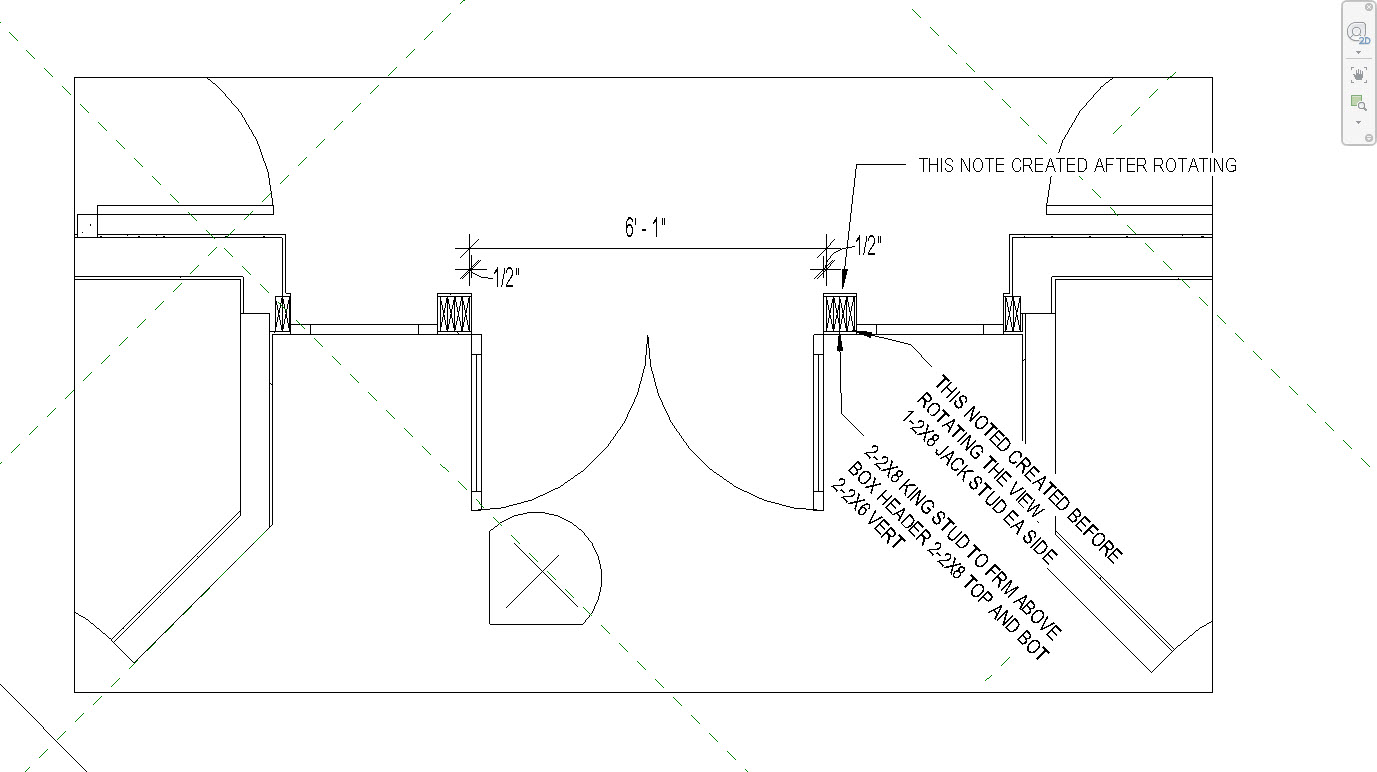

Quick caveat:  Create the view, rotate it on a sheet FIRST, then start detailing it or else all of the notations well end up rotated as in the original un-rotated-on-sheet view.

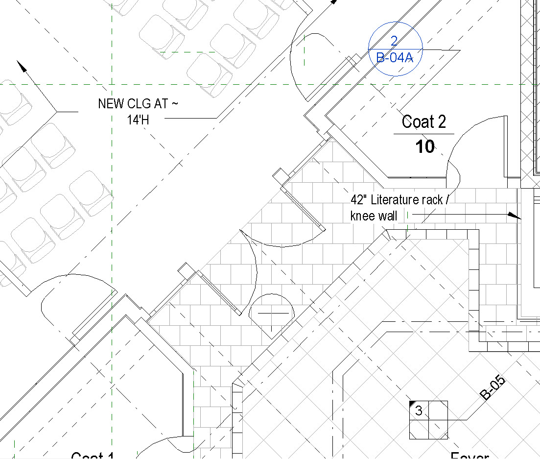

Mr steve: scope boxes are the answer. You can have several scope boxes with different rotation each, and when you asign an scope box to a view, the view automatically matches the rotation of the scope, as happens with the autocad Ucs.
