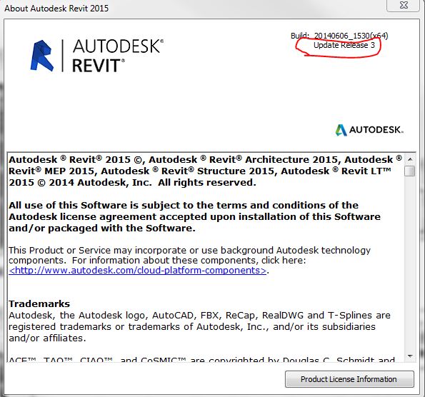

I have far clipping set up in an elevation view. If I zoom in or out in the view, the far clipping stops working throughout the project- I can see the full view depth in the elevation, and in plan I can't adjust the clip depth. If I switch the clip to "reset" from clip with to without line, the view is clipped (in plan and elevation)- but the second I zoom, it all resets again. Does anyone have any experience with this delightful bug? I'm in Revit LT 2015.

All my security packs are up to date (the only one out for 2015 LT is a security patch for heartbleed). I should have mentioned that it's only exhibiting this behavior in one view, so I don't think it's a video card issue- particularly since the clipping is also turned off in the plan view when it turns itself off in the elevation view, which suggests to me that the clip/ no clip property of the view is what's causing the problem.

Sorry for the duplicate post- but, to quote the Revit Update site "After Update Release 3 is applied successfully, the build number specified on the Help > About dialog will be 20140606_1530."
So, as I read it, the build does have something to do with the updates- and I missed update three on the page due to the layout of the webpage. I'll try installing release three and seeing if it helps.

You build number should have what update it is, as WWHub said, the build number doesn't matter its your update number.

You are correct.
Typically, Revit's updates are only patches and must be installed in order.   I see that this one includes the previous patch.
Sorry about my mistake.

Looks like update 3 fixed the issue, in case anyone else out there in the internet is having similar issues. I'm going to have to get used to managing my own updates again...
