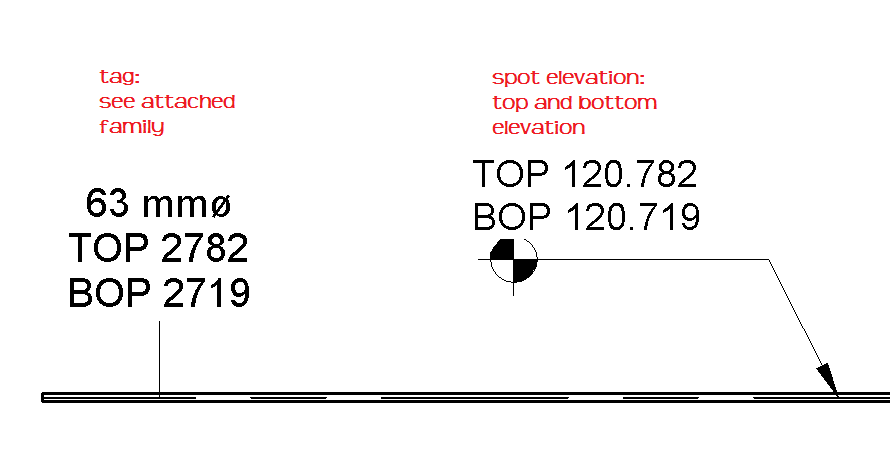

hi
im so sorry, i thought you will be able to figure it out yourself
well, you can use your HELP command and read about tagging.
anyways. i have attached and example with 2 ways of tagging it. hope you will find it helpfull
its in revit 2013
ty
(sorry i cant attached the project.. only screenshot for you!)
