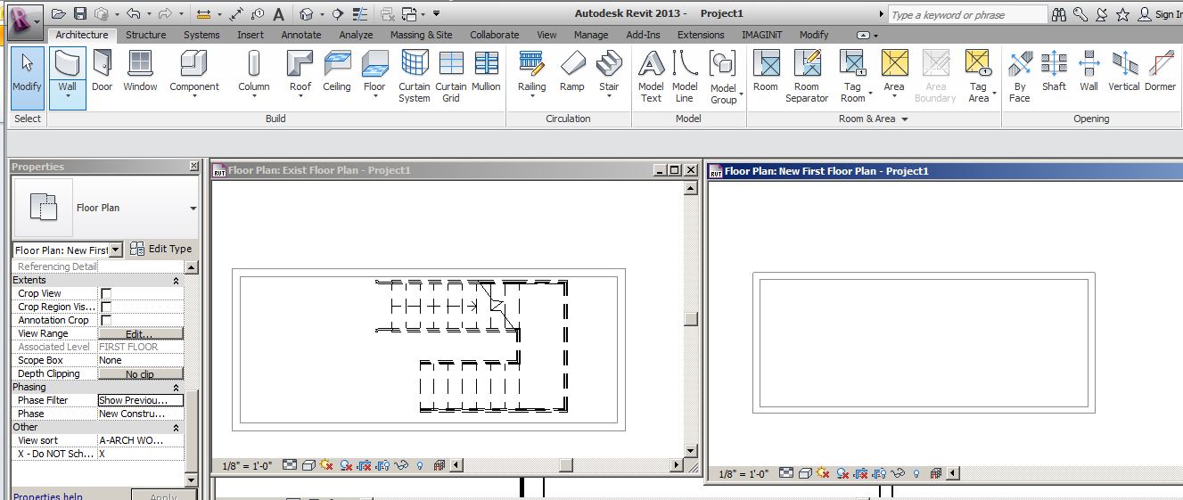

Hello all,
so ive demolished my stairs. and it disappears from my views...except my floor plan.
the stairs kind of hides itself, but leaves this diagram of the stairs that I cant even hide in the view. notice the greyed out options. can someone tell me what Im doing wrong?
the view is set to show only new and existing so its not that. the stairs ARE demo'd but you can demo this stair diagram thing (this is new to me in 2013)

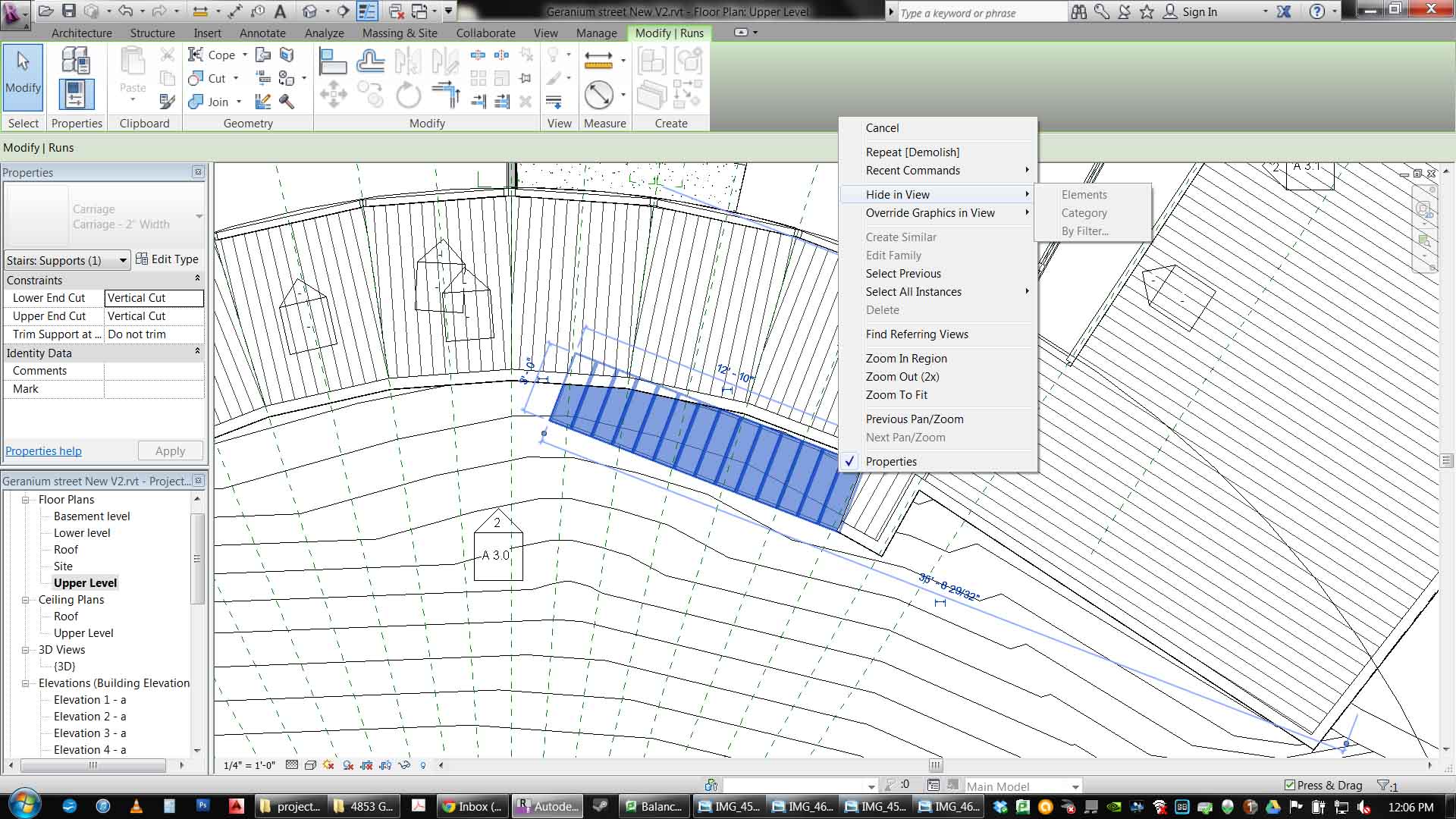

Note though, I have selected the carriage in my view. the stairs disappears like yours, but the weird object "carriage" stays there. does this make sense? its like the stairs have two parts, the stairs themselves and this carriage object whick is completely seperate selectable object...

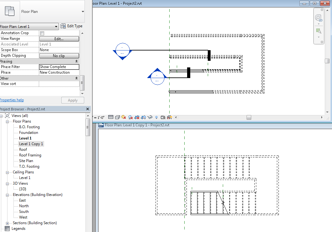

Im having this problem again. on another project. I have all the service packs. look at this image. The stairs are demolished. but this artifact of the stairs remain. you cant choose to hide it. its greyed out. cant choose to set it to demo or not because there is no option for it in the properties. its like the stair is gone but this secondary stair thing wont leave. I will have to simply delete it from the project to get it to go away. please help me :-(
Wed, Aug 13, 2014 at 1:26:44 PM | stairs wont demo off my plan
View setting>>  "show complete"
I have that in 2015 and the stairs demo just fine.
Upper view - properties as shown
Lower view - show all - existing phase

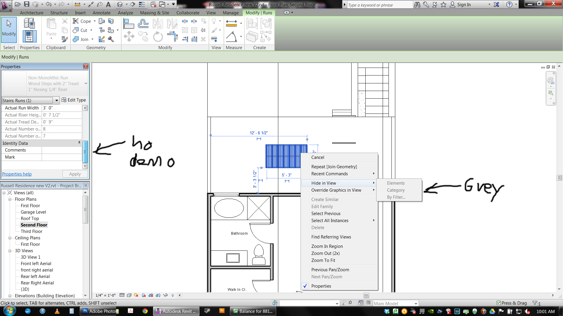

Thanks HUb, but Im still a little lost.
Im going to post the model (stripped down)
Ive also (for reference) added the two types of stairs you can draw, ie. by sketch, or by component.
they both work fine. the stairs in question are like a third type. "assembled stairs" (when you select it)
Since there is only two options for making stairs, where did this third type come from? How did I draw it, if there is only two options. Help files are a little dry on this subject, and the videos I watched focus on basic assembles parts (though not sure if its the same thing)
