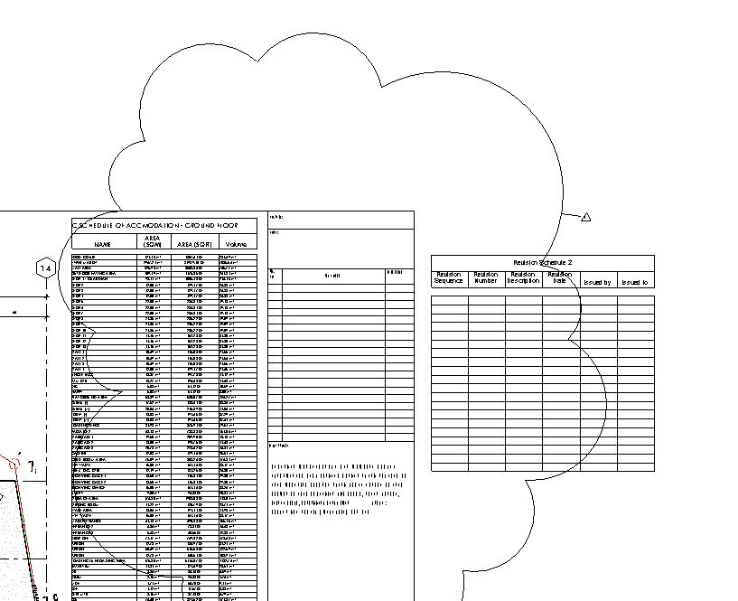

was having dificulties on working with revision.I did the revision cloud and tagged it . so my problem is:

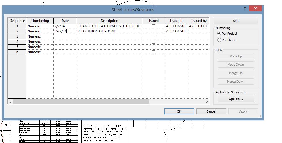

1. the tag no appeared when 'per-project' is checked in the sheet issues/revision field but it was otherwise if 'per-sheet' is checked. What is the different between these two?

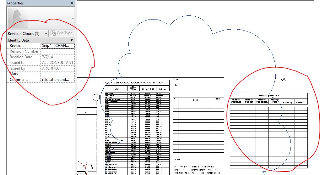

2.athe revision information is inserted but does not show in the schedule.

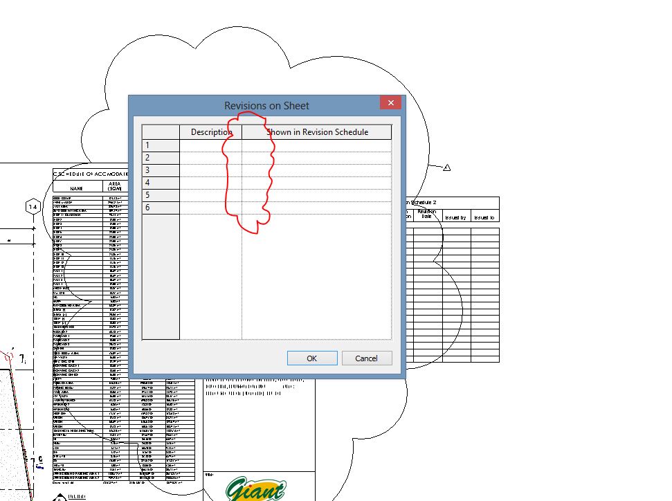

3.revision on sheet: there is no check box in the column of 'show in revision schedule'
do i missed out some  step here?
very much appreciate your help. thank you

depends on how u created your (sheet) title block and how u customize the fields of your revision schedule.
i suggest u add all the fields, and hide the unnecessary field.
1.a. per project: revit will show the REVISION SEQUENCE in the sheet. but numbers/letters will be skipped (1,3,6)
1.b. per sheet: revit will automatically adjust the revision numbers/letters so it will be in sequence (1,2,3)
2. something is wrong in there... even a newly created project (empty) has a default Revision 1. and a newly inserted sheet will show Revion 1 in the "revisions on sheet" panel.
Thu, Jul 10, 2014 at 7:43:12 AM | REVISION TAG AND SCHEDULE
The revision schedule has to be part of the sheet family - created in the family editor.
