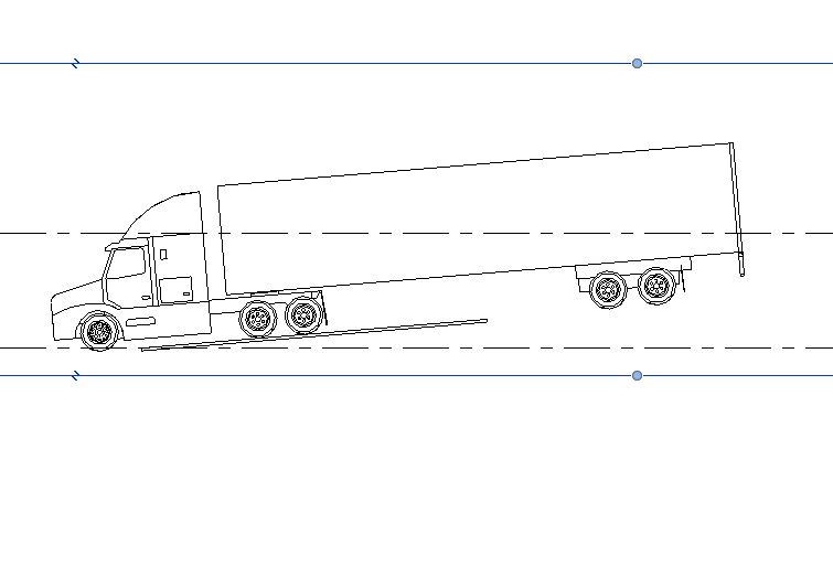

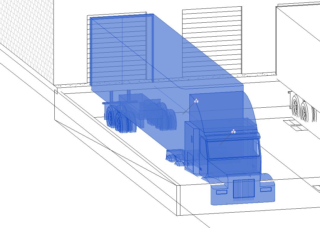

In the family uncheck always vertical and check workplane based.  You can then either use Edit Work Plane or use the Pick New option in the project
Wed, Jul 9, 2014 at 1:50:22 PM | PLEASE HELP! ROTATING AN ELEMENT ON A RAMP (Revit 2014)
Your family set to work plane based / always vertical unchecked and placed on a ramp in a project.
