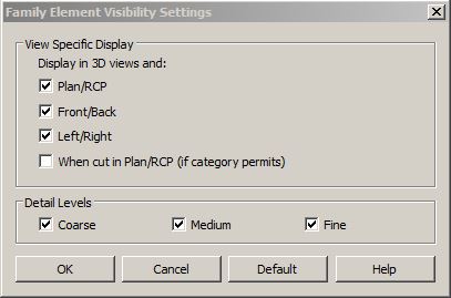

I have a seemingly peculiar problem. I edited a cabinet in order to have custom profiles on the doors and in doing so I needed to create a void extrustion to trim off some unwanted door. The void cuts perfectly fine in the family editor, some cut automatically others require me to use the "cut" tool in combination with the void but regardless everything works fine. BUT when importing the edited cabinets into my project some show exactly as edited in the family editor and others show as if no void extrusions had been applied to the cabinets. In addition the "cut with voids when loaded" option was infact selected each time to no avail.. Out of desperation i even tried applying voids in place in the project to see if that would work instead, but when applying the cut geometry tool, after selecting the void, it doesn't allow me to select the cabinet.... My hands are currently tied and revit is making zero sense to me. Someone please help me, this is driving me insane, and wasting SO much time..

I believe your problem is the visibility settings in the family for the individual elements.  If you want elements to cut, you need to check  "when cut in plan/rcp for each element.

Thank you for looking into it for me. Your suggestion didn't solve the entire problem but has helped me make more sense of things and ensure that the visibility settings are proper so things do work properly. I have found the problem to be the result of a couple of things that i wasn't doing. For one, when applying the void, i created a reference plane which i associated it with, this reference plane caused problems with the constraits of the family itself causing it to not flex properly. So what i did was associate the void with planes already in view, what this did im guessing, besides preventing problems with flexing, is create a void that was permanently apart of the cabinet thus when importing it into the project it remained(this worked every single time for me). Im figuring this is the case because when associating it with my own plane the void didn't immport properly in every case. Also on another note i realized when flexing the cabinet in the project the void didn't follow the change in flex but if you lock the void to the desired edge (edge not plane) it flexed perfectly with the void each and every time.
For the record Im not sure if I have explained my findings sufficiently or if im interpreting things properly but what I have explained above I believe to be correct to my understanding.
If anyone can explain to me why using my own plane doesn't work to properly flex the void with or why using your own plane causes flexing problems even when it is unassociated with the family i would be very interested to know why.
