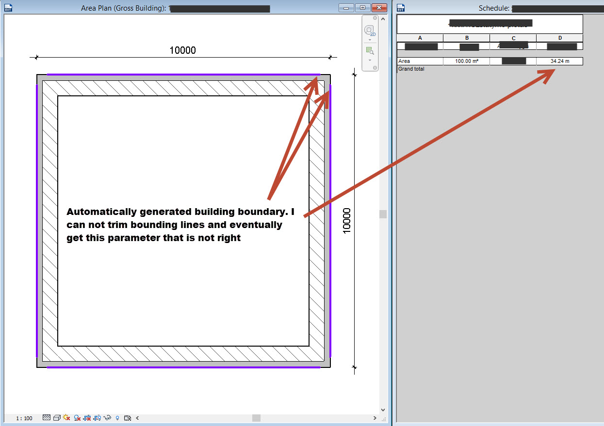

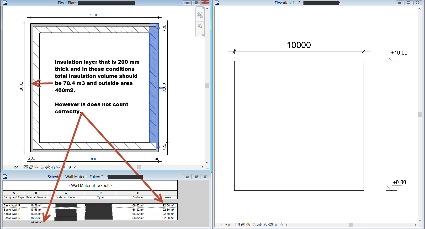

Dear revit users,
recently I have experimented with revit schedules. After some time I have noticed that material takeoff does not work correctly (maybe I am doing something wrong) so I updated Revit arch 2015 to Service pack 3. Still I can not configure material take off to work correctly, please see the attachment.
The problem is that revit counts everything excluding corners, which is strange thing. I believe, that this is my lack of knowledge. Please advise me how to make it work.
After doing some manual work, that is shown in the pic. everything seems ok. It normal or is it a better way?
Thank you in advance.

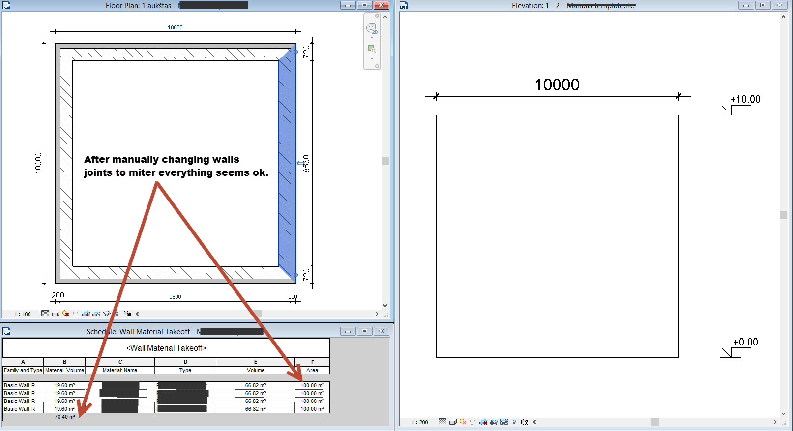

Mon, Jul 7, 2014 at 5:17:22 AM | REVIT 2015 material takeoff, gross area issue
serialkill
Joined: Tue, Mar 16, 2010
8 Posts
Manual correction.

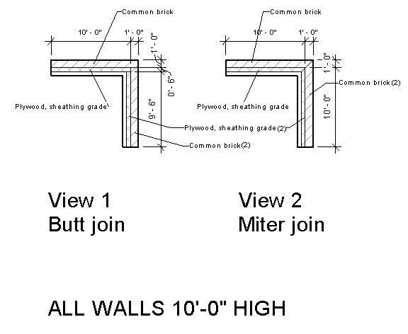

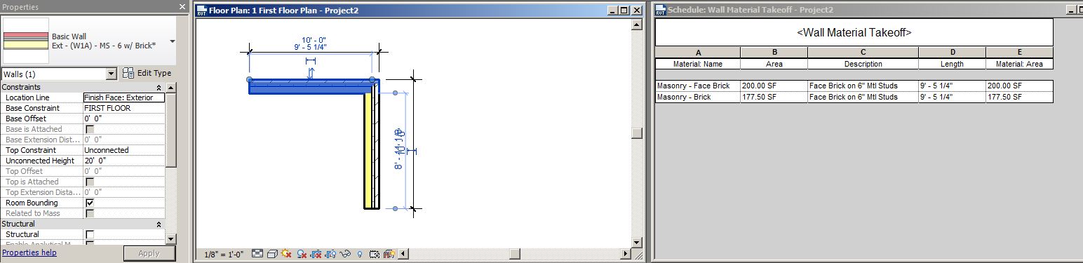

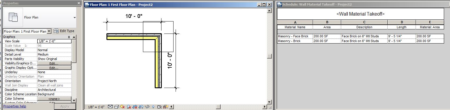

Revit works correctly - you need to do some testing to learn how it works.
In the images below, I have two different walls with different brick both are 10' long from the outside corner.
In the first image, I used the standard joint.  Note that the brick area and the exterior wall face area are the same for the individual walls but they are different from each other.  Why?  The thickness of the brick at the corner is subtracted from one wall.
In the second image, I changed the wall joint to a mitered joint.  Now both walls have the sam exterior face and material area.
This is the same for all layers in the wall.

Because of your post, I tested your question and found there are errors.  I have created a project and questions that I will be submitting to Autodesk.  I'm pretty sure that this used to work correctly in versions earlier than 2012 but I don't have those installed anymore.  I tested on 2012 and 2015 and found the same errors.  Here is what I am writing to Autodesk.
We have found some real inconsistencies and errors in material takeoffs in Revit.  This problem seems to be the same in 2012 through 2015.  Please explain.
Why are material areas incorrect?
Please look at the following plan and material schedule: <Image 1>
  • View 1 has two walls with different materials in each wall using a butt joint
  •  View 2 has same two walls but a mitered joint

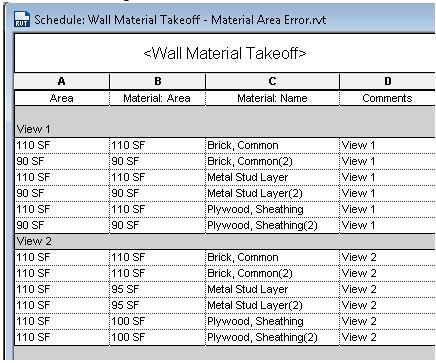

Look at the following material schedule <image 2>
  • ·         View 1 – The material areas for the exterior brick is correct for the two walls.  (Note material name for vertical walls are (2))  The takeoff accounts for the material thickness.
  • ·         View 1 – The material areas for the sub layer is incorrect and the same as the outside material – not the interior material asked for.
  • o   Plywood, Sheathing should be 100 SF
  • o   Plywood, Sheathing(2) should be 95 SF
  • o   Metal Stud layers should both be less than sheathing layers
  • ·         View 2 – The material areas for all materials are based on the mitered joint face of each layer
  • ·         View 2 – Unlike the butt joint, the thickness of the outer material is subtracted and the mitered joint face is used.

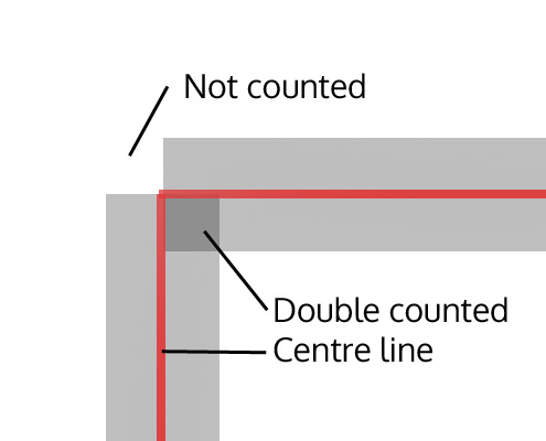

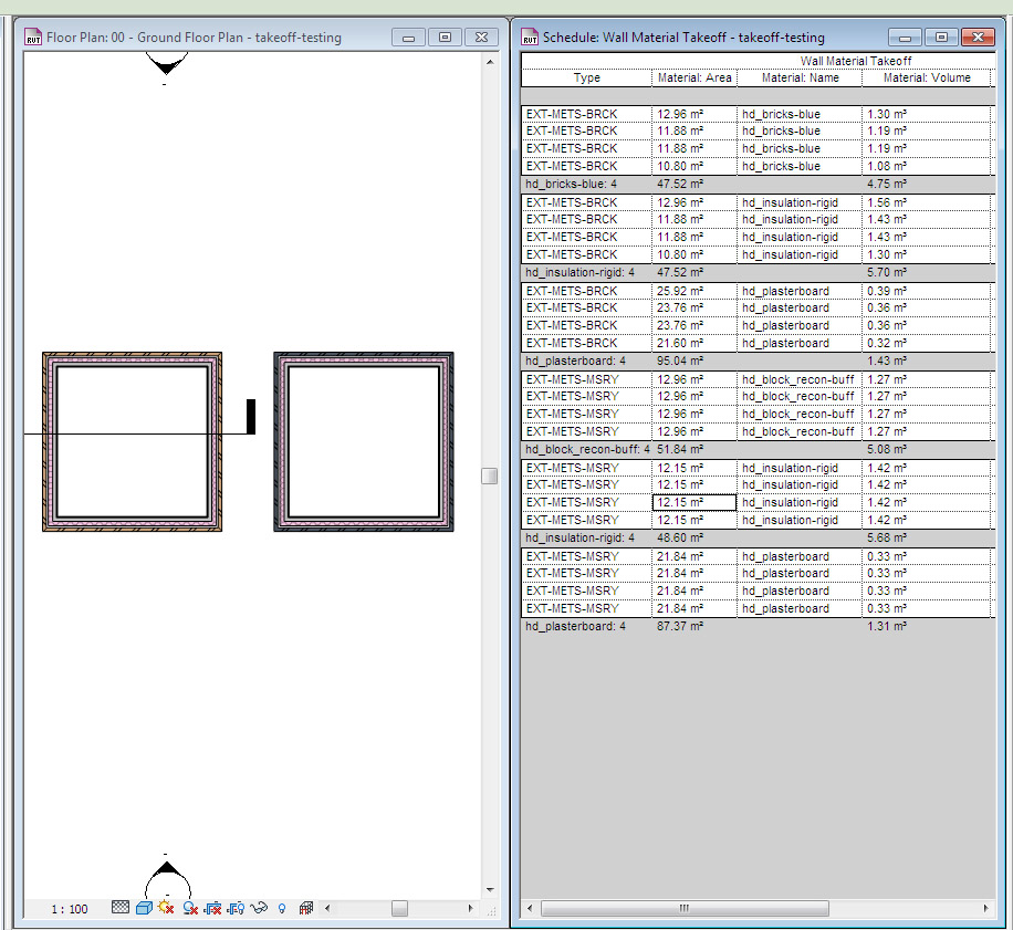

Hi, just wanted to pitch in to say I've been having the same issue and have run tests that verify that the centre line is used for calculating the area of every layer in a given wall. In my case a ran tests on a 4m x 4m box with a 400mm thick wall - the schedule returns results based on a length of 4400mm - the wall length plus 200mm to the centre on either corner. This means that when you miter the joins, the schedule ADDS material to the external layers and SUBTRACTS it from the internal ones ie. if you don't go through the miter process, you'll have estimated too much plasterboard and not enough bricks! You can see in the attached image that the insulation value is almost the same, as it is closest to the centre of the wall. The left box (blocks) is mitered, the right box (brick) is butt joints. Have attached a diagram for clarity.
