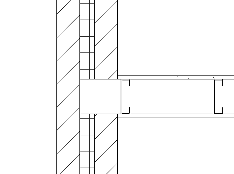

In the attached images, you can see that the core of my stud walls are penetrating into the other walls, even though I have it set up as a butt joint. Moving the extent of the wall profile in elevation does not change this problem either. Has anyone run into this and know how to fix it?

Read this topic from your HELP - it is a priority issue:
http://help.autodesk.com/view/RVT/2015/ENU/?guid=GUID-1CCD1005-CBDA-4338-8D60-489095D4BB25

Thanks so much! This was the problem.
