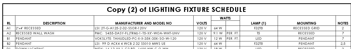

Using the Revit Schedules, you can either have lines dividing your cells or no lines at all.  There isn't an option to remove a line between cells.

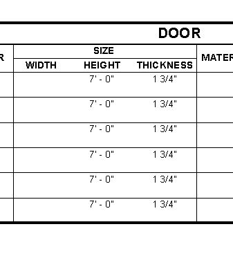

Not true... here is a schedule with both sides of the door height column removed.

This is as close as I could get.  Re: attached

I have looked for that before,  now I see it for the headers, but it doesn't want to give me the option for the body.  In the attached image I have tried selecting both the two cells and the entire columns and both ways, the borders options are not available.

Click on the schedule column A-B-C.... Then pick the borders tab.

Thanks, I can get it to work now.  Sometimes you just have to hit me over the head with the letters...  I kept highlighting everything below the letters and could not get it to work for me.  Now I see.
