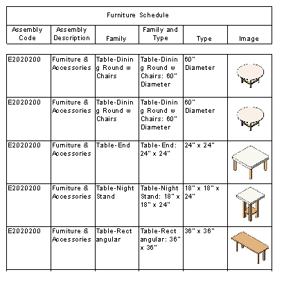

Thoughts - Learn to use the power of Revit and that is in its schedules.  Don't try to make Revit act like a spreadsheet because it will not.
Revits schedules are horizontal fields - not vertical.  2015 allows you to use images in a schedule so schedule your wall type per family in a horizontal schedule.

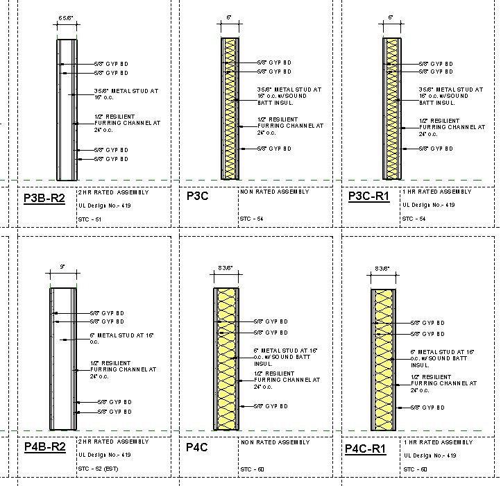

I missed ...or maybe just disregarded your statement about using a drafting view.  Again, Revit has maybe some more powerful ways of doing this.  Legends.....
We have a resource project that has just about every interior wall type already set up in it and documented in legends.  Then we simply copy the legend with material notes into our project wall types legend.  This brings along the wall definition so we now can use that.  Here is a small example of some of the material tagged and noted legend components.
