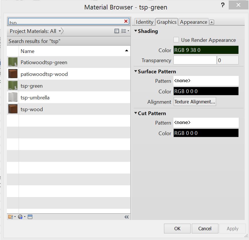

I did exactly as you said. I deleted the component from the project. Opened it as a family and from there renamed the materials (originally it was tspwood and so on, I renamed it to patiotabletspwood) then I loaded it into the project. Then I went to materials and checked if everything is okay. And both of the materials were there (refere to the attached image). But its STILL RENDERING GREY Sad
Please help!

Take a screen shot of your material browser in your PROJECT so we can see what you have under the appearance tab
Mon, Jun 23, 2014 at 10:30:37 AM | Objects/Components render GREY?! :(
It sounds like the objects in the family may be set to default rather than a specific material.  Just because the material exists in the family doesn't mean it is used.
BTW - you will have to delete all of the families from the project, including from the browser then delete the material from the project if you want to reload a new material by way of loading a family.

I did what you said. Deleted the component form the project. Purged the unused. Deleted those materials from the project material library. Then loaded the compnent again. And now even the umbrella is NOT rendering white, which it was earlier :/ Now the WHOLE OBJECT IS GREY Sad
Attached the screenshot of the material appearance. .
HELP!

Now we see the problem.  This is a CAD import into a Revit family.  Materials for CAD imports are controlled by CAD layer assignments.  EVERYTING in this CAD import is set to layer 0.  So every item will be the same color as assigned to layer 0.
I changed your layer 0 to green in the project.  The umbrella is a nested block and it will not respond.  I suggest you edit the CAD to place these items on seperate layers.
