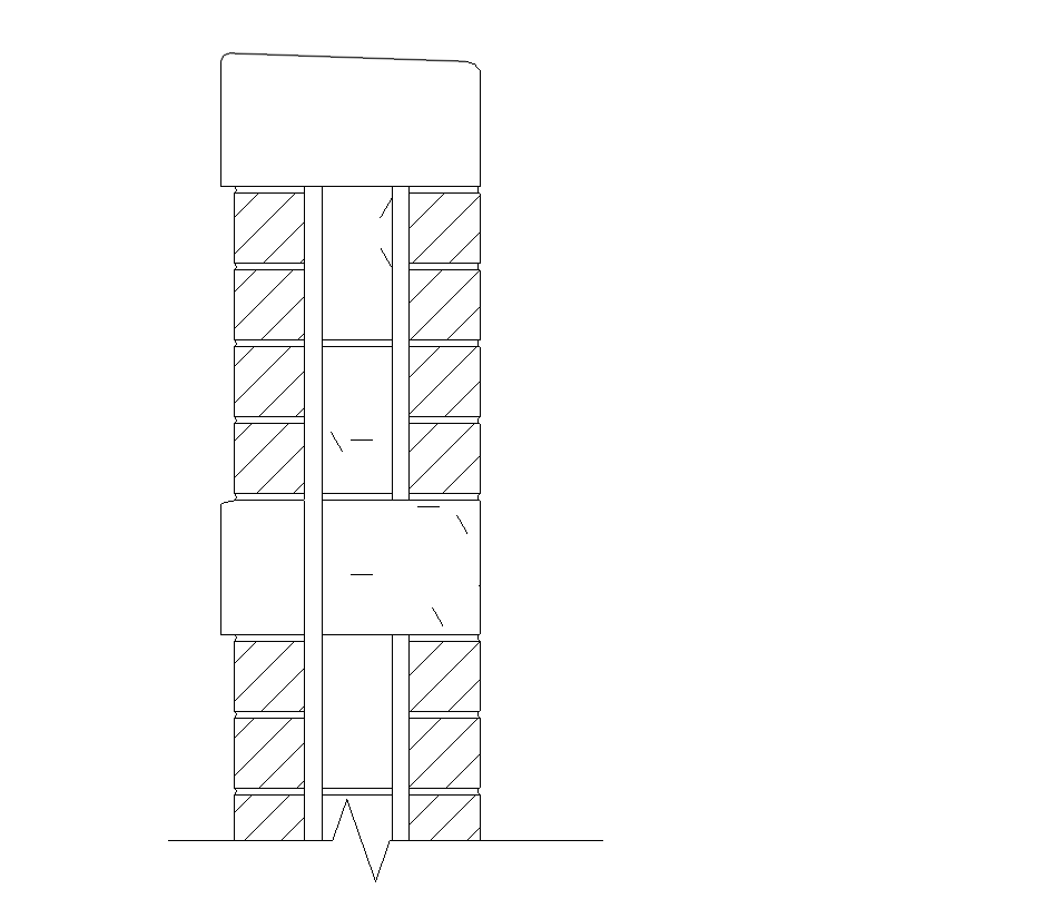

Im trying to draw a stacked wall with materials that have angels/rounded edges that lead up into the next material. I have attached a picture of one of these wall sections so you can see what Im talking about. I know I can just draw the wall with 90 degree angles and put masking over the straight parts to create the 2 degree angel/round corners, but I'd rather do it correctly is possible.
I appreciate any advice, and I apoliize for not explaining it well but I have no idea how else to describe it. I hope the picture can clear up any confusion (I drew in with detail lines, thats not an actual stacked wall)
*There is a 2 degree slope on the precast cap, corners are 1/2 radius*

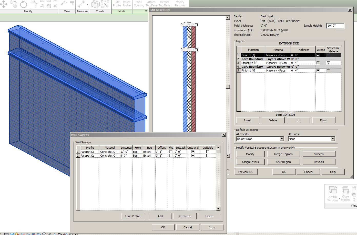

Don't do this as a stacked wall.  Simply do it as a wall type with embedded wall sweeps.
