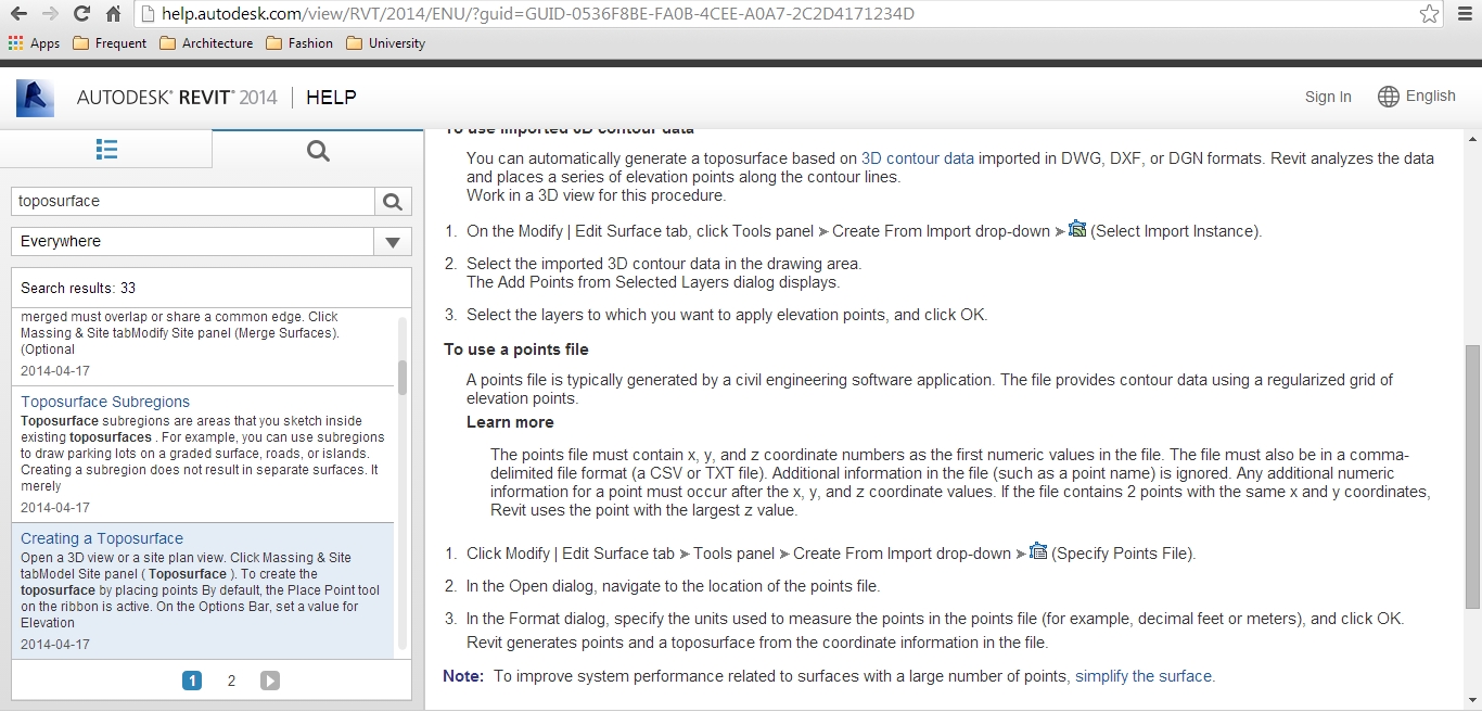

We have a survey created from an external source which we would like to import into Revit to use for the site toposurface. The survey was created using a program called MultiPlane.  The file was supplied to us in a .dwg format however Revit would not read the information in the file so our next idea was to try importing the .txt file data instead.  The .txt file contained only x, y and z points as per Revit Help (see attached).
Both times Revit would not read the information and no toposurface was created.
Any ideas on how we are able to still utilise the information provided to us in these formats and be able to create the toposurface?

Both the CAD import process and the points process are pretty straight forward.  Your process may be incorrect.  Without looking at youf files, we don't know if the data is incorrect.  Try a different CAD file in a test project.  If that still doesn't work then look at your process and follow the Help.

Just an update, had to manually create the toposurface from the given x,y,z co-ordinates.
The .txt file was not set up correctly when our consultant created it so Revit wouldn't read the information.
