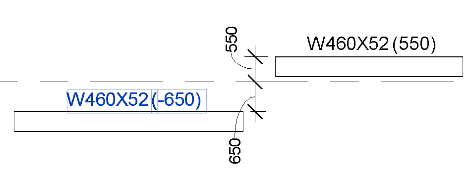

Are you placing a 'structural framing tag' ? If so I don't see a supplied tag that puts in the 'elevation' with or without brackets so I made one and attached it with an image file showing what it does.

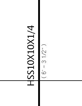

dgcad,
How did you make that?
I have attached the exact format I am looking for.
