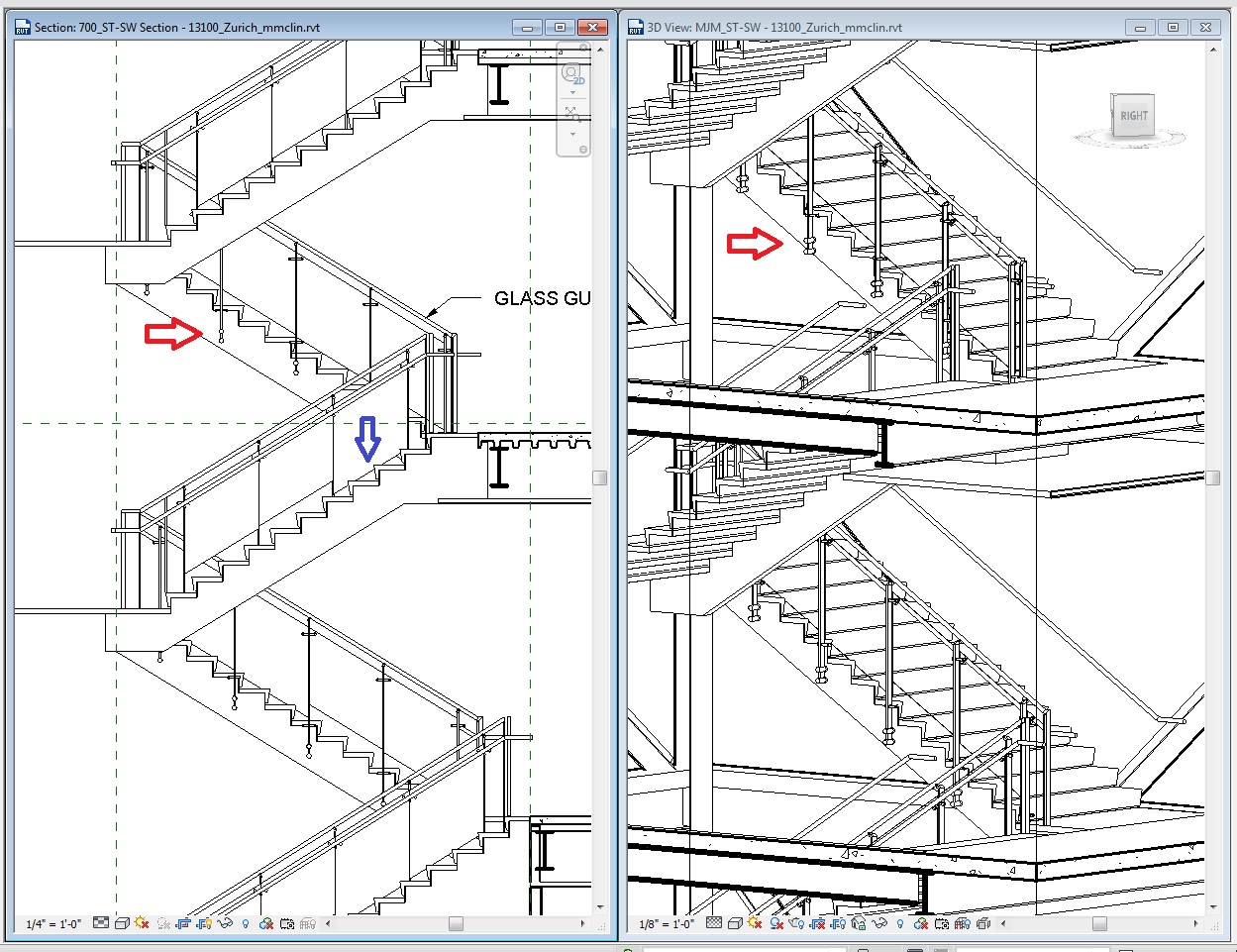

I've created a guardrail for a stair shaft, but some of the balusters seem to change in height along the run of the stair. If you look at the attached image (red arrows) the baluster appears to drop a few inches relative to the other balusters (the next baluster up the run appears to do the same). What's even more strange is that in the stairs below, the balusters are in line, but the glass panels vary in height (blue arrow).
All of the stairs are the same, the only difference is that the run with red arrow has 12 risers while the run with the blue arrow has 11 risers.
I initially thought there was a break in the path that was causing this, but the guardrails along the stair runs are drawn as a single line (not multiple segments).

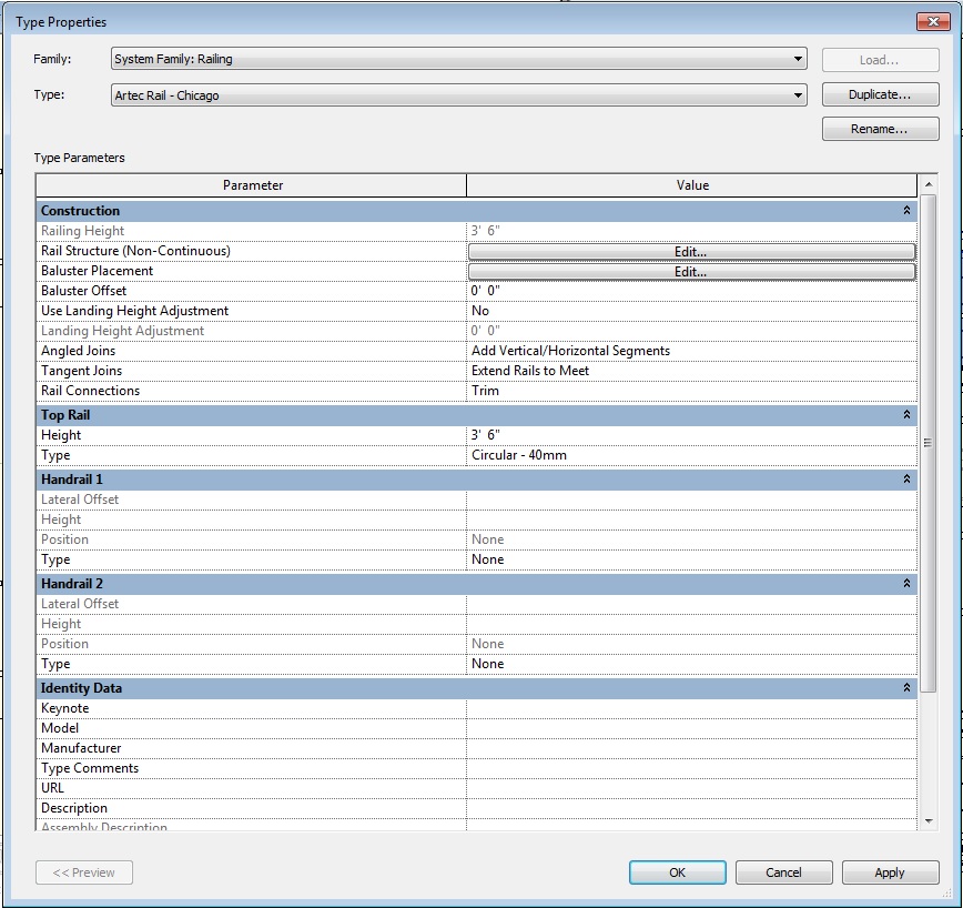

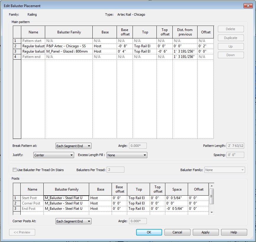

I've also attached the properties and baluster properties of this railing. Can anyone provide any insight as to what's going on and what I can do to fix this?
