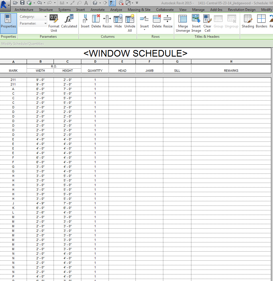

Wed, Jun 4, 2014 at 2:22:32 PM | window schedule by mark and count
ledgewood33
Joined: Wed, Jan 27, 2010
34 Posts
5 Stars: 1 Votes
I do have the count parameter in my schedule. but it lists each individual window in the type mark column. i am attaching an image of what I have described. in column A (mark) I would like it to list the window types and not every window instance and then in column D quantity it should list the count for each window type. so in my attached example I would like there to be only one row of mark 'C' and in that row under quantity it would list 3.

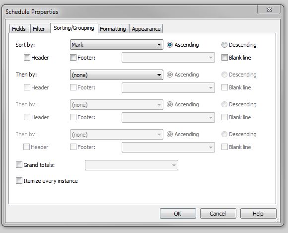

Wed, Jun 4, 2014 at 2:25:53 PM | window schedule by mark and count
Uncheck itemize every instance in sorting.
Wed, Jun 4, 2014 at 2:27:49 PM | window schedule by mark and count
Johnzo142
Joined: Fri, May 8, 2009
47 Posts
In your schedule properties under sorting/grouping, uncheck itemize every instance.
Wed, Jun 4, 2014 at 2:31:52 PM | window schedule by mark and count
ledgewood33
34 Posts
5 Stars: 1 Votes
THANKS FOLKS.
just as I replied earlier I realized that I needed to uncheck itemize every instance
