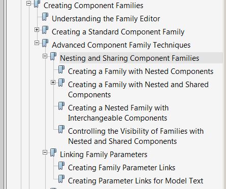

Scan through the guide and you will see the applicable segments.  In the meantime, here are some pointers:
  • Door families will all schedule as doors.   Is that really what you want ?
  • Nested families CAN be controlled by the host but not by instance variables - only type.
  • In order to schedule parameters, they must be shared.
  • We always schedule the frames and thepanels in the door schedule but we do that using type parameters - not seperate familes.  The type parameter controls symbollic lines and model elements.   Really a better way to go!

Read these sections in the families guide.
