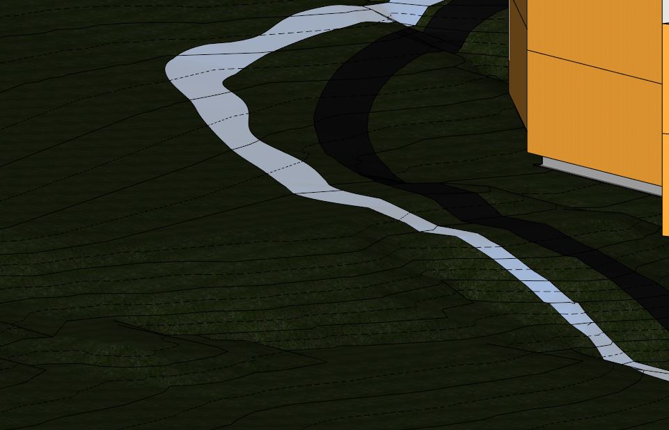

What is the easiest way to make a river in a topography ? If a use a sub-region or split-region the water has no bottom. And a the site slopes, it has too many place-points to change manually..

Put your points in that make the actual river shape and depth and then use a floor for the water.
