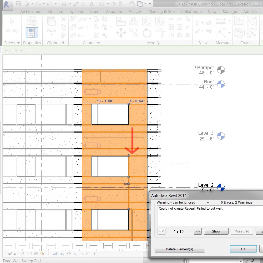

I'm running into a bit of a problem, and looking for the light at the end of the tunnel.
I have a project with a few horizontal reveals (defined as part of the wall type) in a wall that spans 3 floors. I need to put intermittent vertical reveals that align with the window openings, but don't span all the way through. I can limit the length of the vertical reveal (from reveal to reveal - 2' above and 2' below the window, but as soon as I move it into position, it expands and runs the entire height of the wall. If I then try to cut it back, it works with me until I cut it back below the top window. As soon as that happens, it wants to delete itself ("Could not create Reveal. Failed to cut wall." and "Could not create Reveal. Two wall sweeps are overlapping.").
Maybe it's just me, but this sounds rather screwy. Am I missing something or is there another (better) way to create a vertical reveal with gaps in the middle?

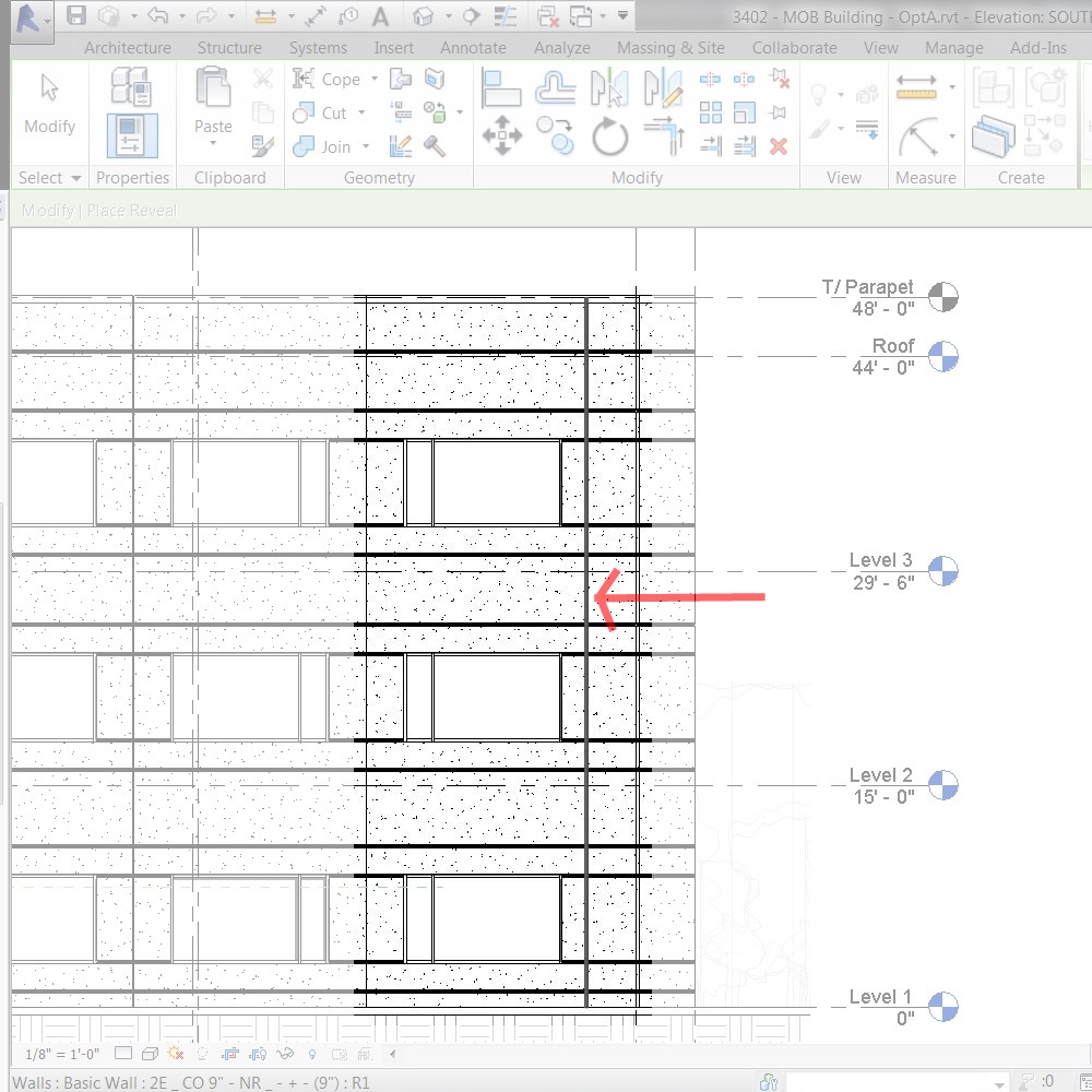

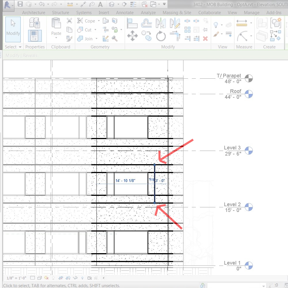

Step 1: Introduce vertical reveal
Step 2: Adjust vertical reveal to desired height
Step 3: Move reveal into position - reveal extends back out to edges of windows.

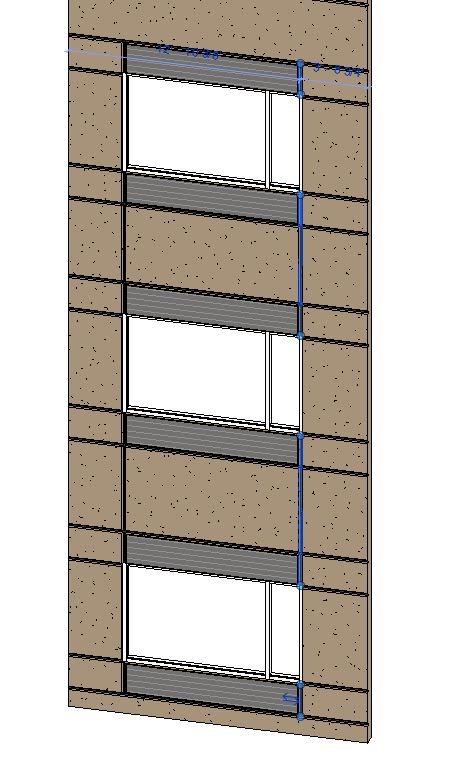

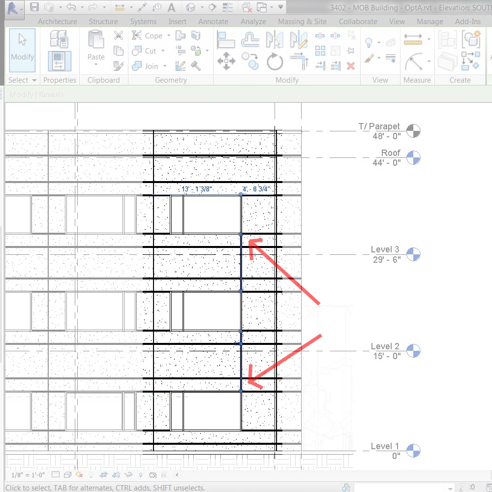

Step 4: If I resize past the window, I get the error messages (the second one says "Could not create Reveal. Two wall sweeps are overlapping). An "OK" answer seems to generate an invisible reveal - turns blue when mouse is over but is not visible otherwise.
Seems to me that's not the normal way for them to work. I could mask, but that's not really BIM.

Actually this is a very annoying bug. It doesn't matter what I do, as soon as I put it in line with the window, it extends to the last window. I'm working at the top window, and I shortened it so the bottom is about a foot higher than the window. As soon as I move it into position, it extends to the top of the lowest window. If I move it away from the window, it reverts to its short version.
Crazy. I guess it'll have to be masking and photoshop. At least 2015 has squiggly lines... :/
