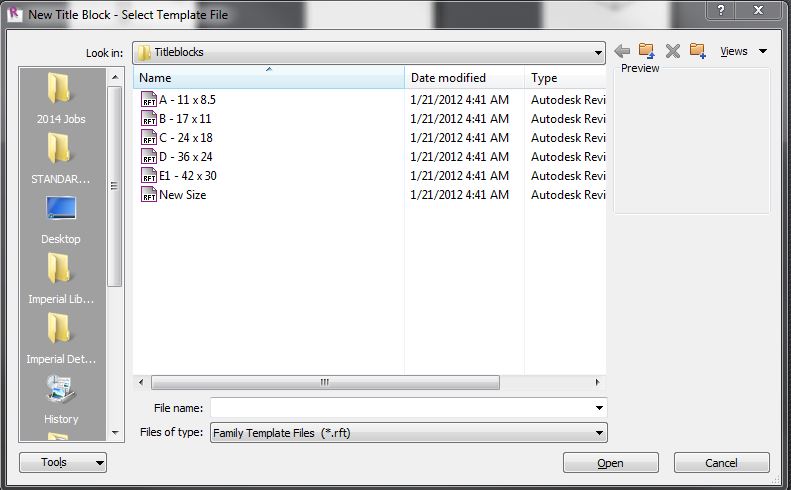

Hi guys i am tryig to make a new custom title block on revit, so on revit i clicked on file- open-new-title block and a small window pops up with my computer staff like other document that is not revit?? where to find the default title block what should i do from here??
i have drawn lots of families before it works fine i just click on new family and there i see lots of defaults files but not for my title block??? my project is due soon
please help thanks

I don't understand.. what happens after you select New>Titleblock?  You should get a dialog box like the image I attached

Hi thanks for replying.. yes i should but the problem is i cant. there is no default title block subfolder in my computer so i can choose a tilte block with my prefered sheet sizes????
is this means i have to make my own revit title block subfolders???

it sounds like revit doesnt want to open or make a new title block at all, because i have an existing title blocks that i can edit or load a new ones, i have tried this to make it work i copied the folder that has title block from load family (ribon) uner insert command. and paste to my document so i can later on open it.
but still when i go to file-open-new- title block i can not find the title blocks because they are rfr formatt i think, even though the actual title block folder that i copy and  past does exist
any help pleassss

We don't know where you placed it.
All of the files that Revit uses that you installed somewhere have to have pointers set to them.  Typically that is done at install but you can 0change them.  The pointers are under the Revit R dropdown / options / file locations.   You can read about setting these in your HELP:
file:///c:/program%20files/autodesk/revit%202014/help/en-us/wbh/index.html
File Locations Options
