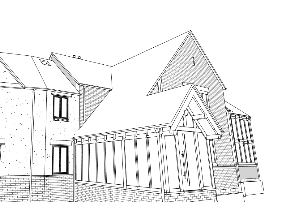

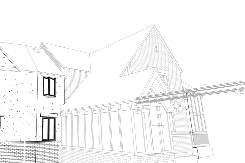

I have now noticed further strange happenings relating to options. In one of my perspective views, the options display correctly (showing the option selected in the view template), but when I go into the editting mode for that option I get lots of stray lines appearing, see attached screenshots. This is not resolved by unlinking the file.
