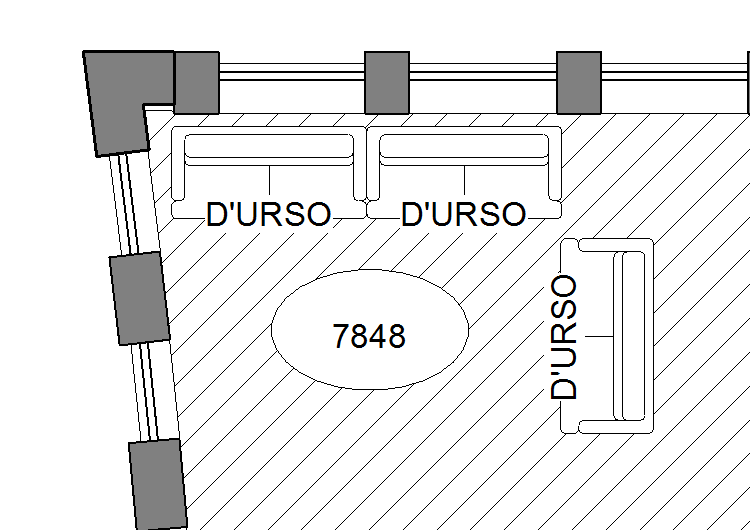

Im really stuck, I downloaded these furniture pieces however I can't seem to find in the edit type where to remove the text/tags in order to replace them with my own reference. If anyone has any ideas I'd be very appreciative, I've attached an image below to explain.

Has anyone figured this out?  I'm really stuck on this.  I've downloaded some office furniture and there is large text on it that I cannot see in the original family file.  I can't seem to find a way to get rid of it.

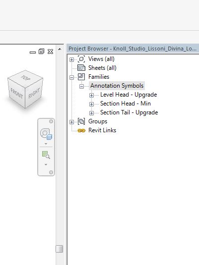

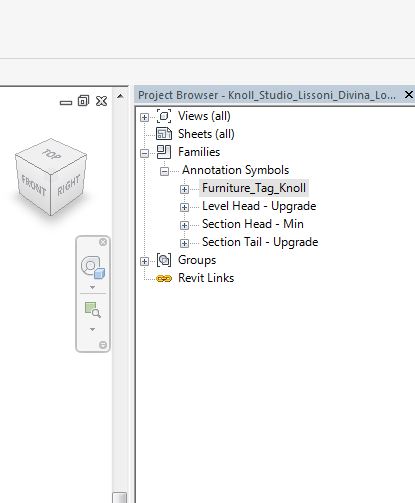

Knoll furniture adds their annotated tags as families within the model you download. Go to your project brower of the d'urso model> families > annotation symbols> right click and delete the tag (it'll warn you you're deleting the family... no problemo it's just the tag family)... and boom goes the dynamite. Before/After what your annoation symbols should look like after.

aaronjburkhart, THANK YOU!
