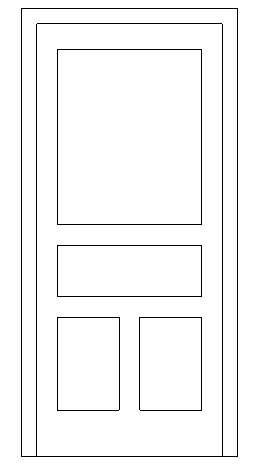

Hello, currently I'm having an issue... I'm unable to figure out how to edit a single panel by changing it into glass on a specific door (I've added a screenshot of it below), I've only been able to figure out how to do it on all panels at once.
Any tutorials would be greatly appriciated.
Thanks!

You will have to edit that door family and assign an instance parameter to the door panel material.  Then it can be edited by instance..... of course you could also make it be a type parameter - up to you.

I'm sorry, but I am confused on what you mean. Would it be possible to more clearly explain on what your suggestion is?

If you need to learn how to edit a family, then find some tutorials.  Also download the "families guide" from the autodesk website.
