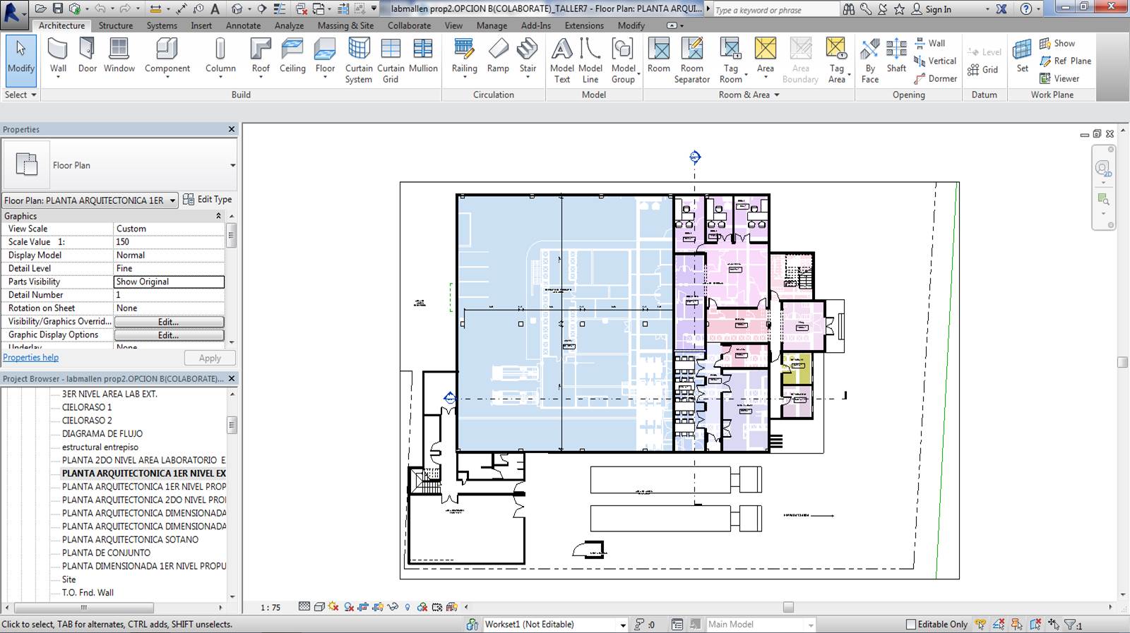

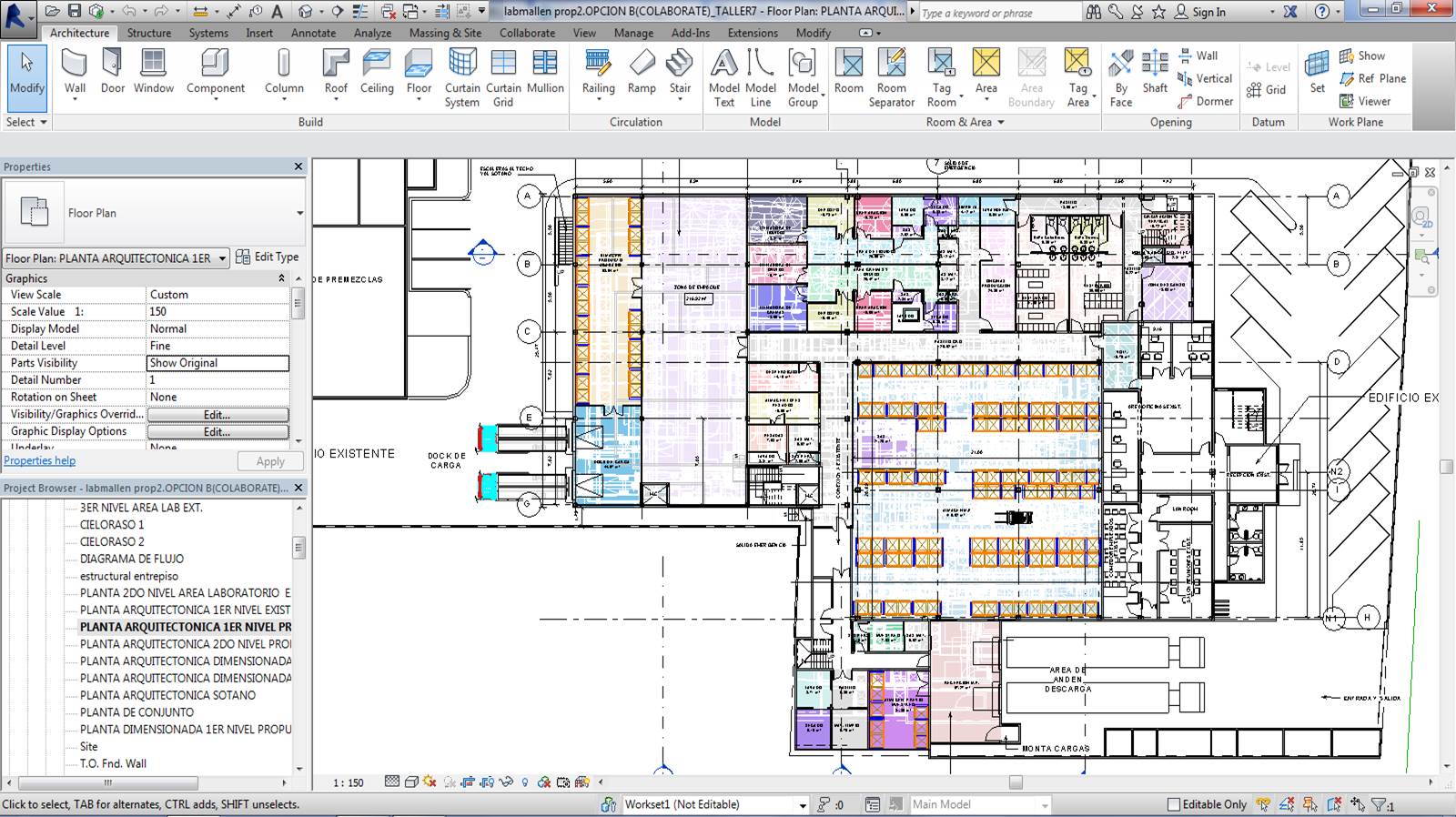

This is happening in my job, house and in classroom computers. How can i fix it. As you can see in the attachment image colors and visuals goes crazy, it happend last week and i cannot find any solution.Most of the pc we use are high end computers with dedicated video cards. We been working normal until last week.  Things i done:Update videocard, drivers, Turn off/on hardware acceleration and Re-intall revit

I think you are seeing another level.
Have you got underlays on?
Did you look at your view depth?
Are floors on?

Floors are activated, view range is ok, underlay is off. and in other PC the floor plan looks normal with its colors, but in most of our pc looks like the attachment.

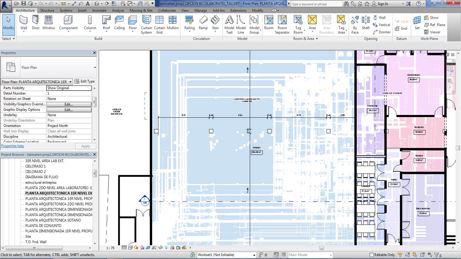

look this one

Turn off hardware acceleration.  Revit R/options/graphics

When the hardware acceleration is turned off. some graphical features will not work. If your CPU is not that powerful, and your revit model is complex, your revit session may become significantly slow. I would suggest that you upgrade your graphic card and use the latest drivers.
