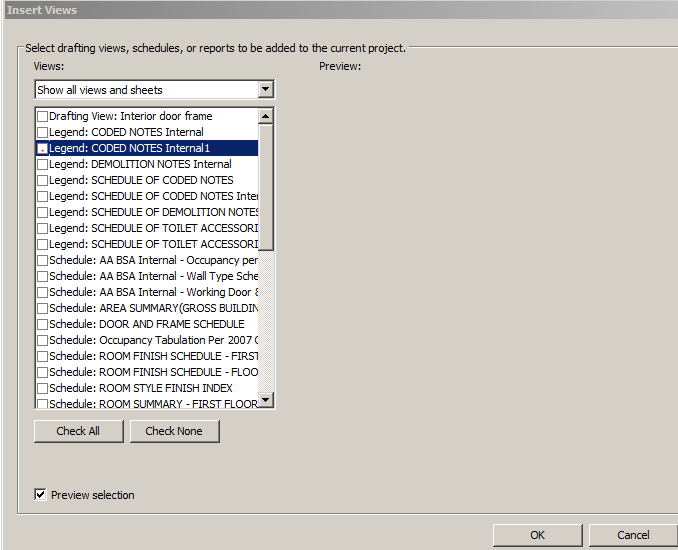

I am trying to transfer two legends from one project to another; however, the copy to clipboard is greyed out.  I also tried to transfer project standards and that did not work as well.  There has to be a way to get legends created in one project into another project.
Wed, May 7, 2014 at 9:50:15 AM | Transferring Legends From One Project To Another
Insert from file....
Wed, May 7, 2014 at 9:51:52 AM | Transferring Legends From One Project To Another
cdhackett
Joined: Thu, Apr 10, 2014
0 Posts
5 Stars: 1 Votes
How if you click on the legend and try to save to file its greyed out as well.
Wed, May 7, 2014 at 10:15:28 AM | Transferring Legends From One Project To Another
You don't understand the process.  The Help explains it.
  1. From the file where you want the legend. - Click on Insert Tab / insert from file
  2. Pick the file with your legend
  3. Pick the legend & finish.
Wed, May 7, 2014 at 10:39:20 AM | Transferring Legends From One Project To Another
cdhackett
0 Posts
5 Stars: 1 Votes

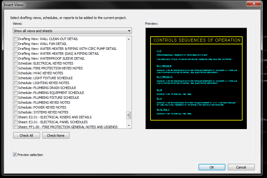

Thank you for the suggestion but that does not work either.  Only sheets, schedules, and drafting views show up.  Legends is not in the list and even the sheet that has the legend on it is not in the list.   It omit its for some reason.  Cannot believe revit doesn't have a simple way of transferring legends.
Wed, May 7, 2014 at 12:13:03 PM | Transferring Legends From One Project To Another
It does work, it has always worked - except for those internals.
Fri, May 9, 2014 at 4:52:47 PM | Transferring Legends From One Project To Another
cdhackett
0 Posts
5 Stars: 1 Votes
Well it doesn't work for me.  I am using Revit 2014. I have attached what it gives me when I go through the steps you gave me.  I am chooseing a job that has two legends in it but it still doesn't show up.
Mon, May 12, 2014 at 8:07:50 AM | Transferring Legends From One Project To Another
Just edit the existing legend - window and copy to clipboard and paste in a new legend in your new project.
