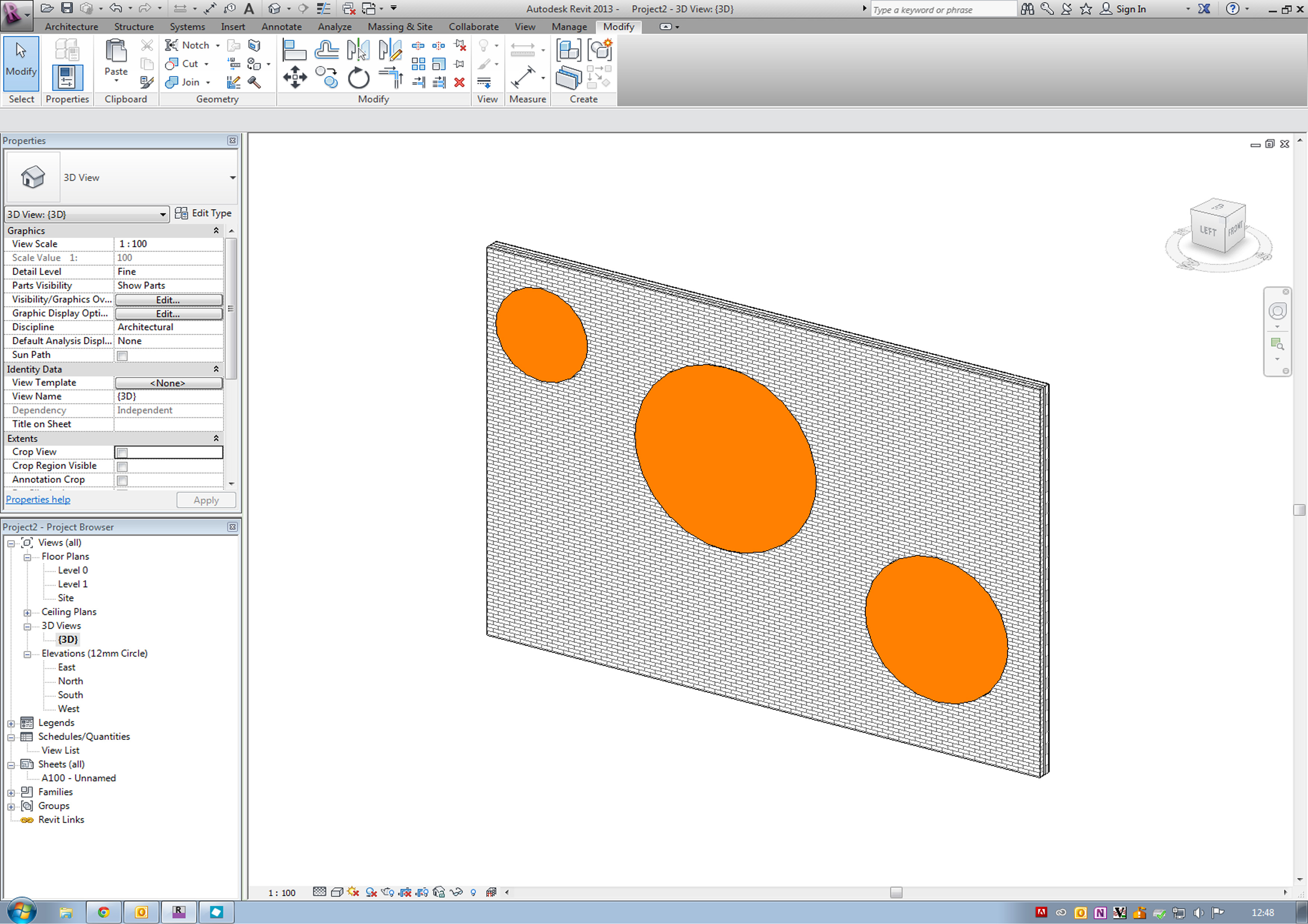

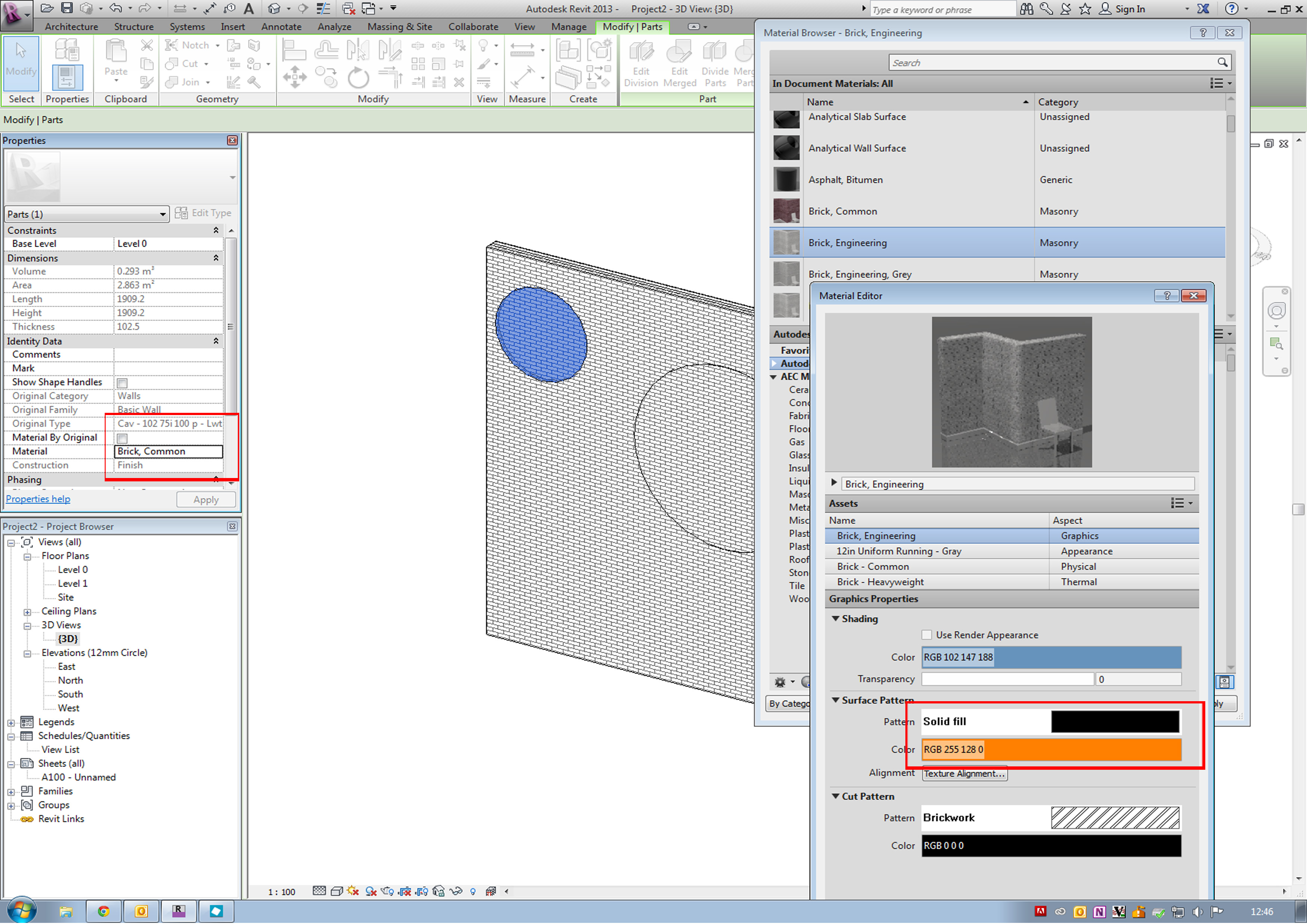

You can go into the material browser and edit the material so that the surface pattern has a colour to it. This means when you change the visibility graphics to Hidden line, every material that you have overridden with turn to the allocated colour.
As shown in attachements:

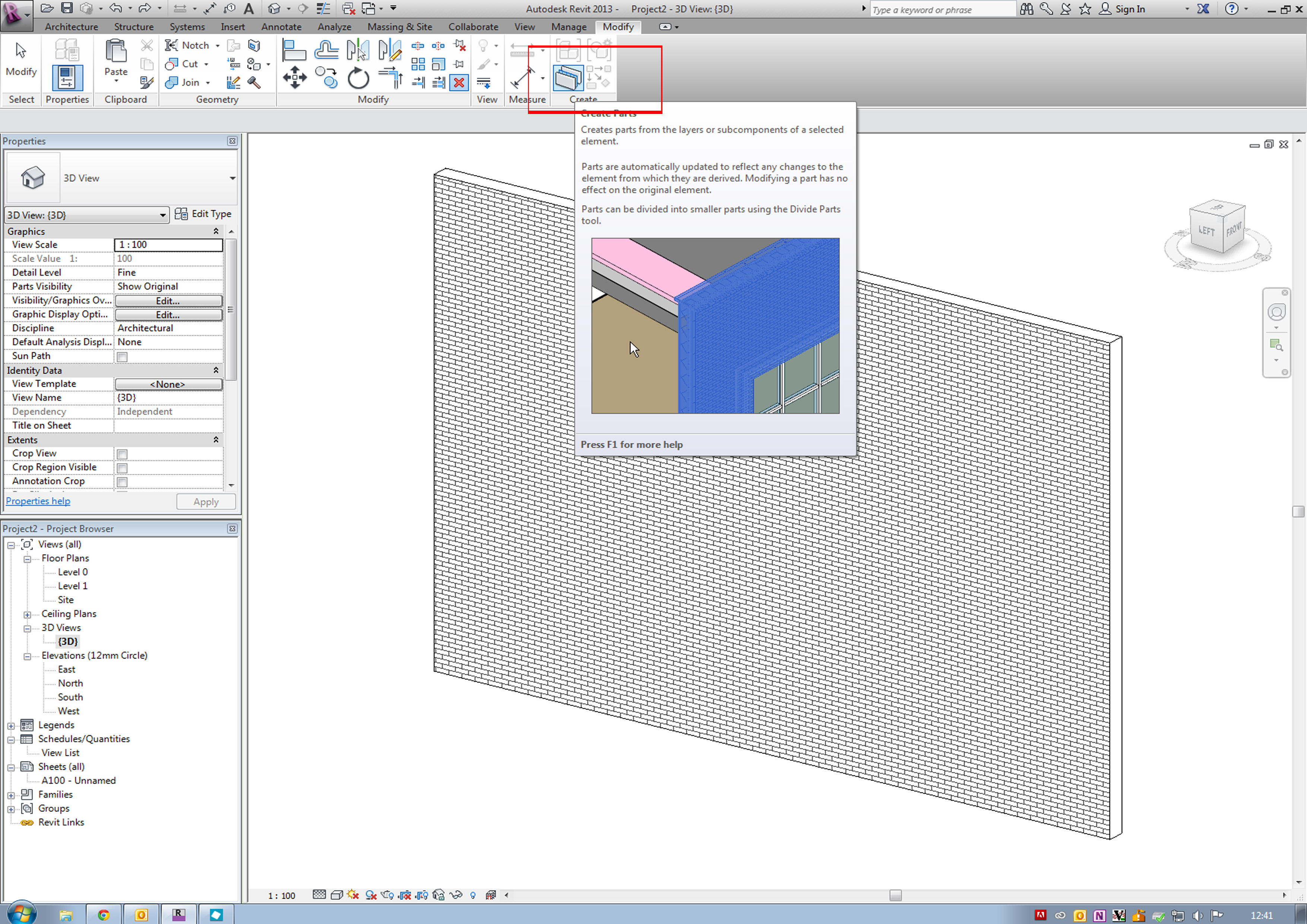

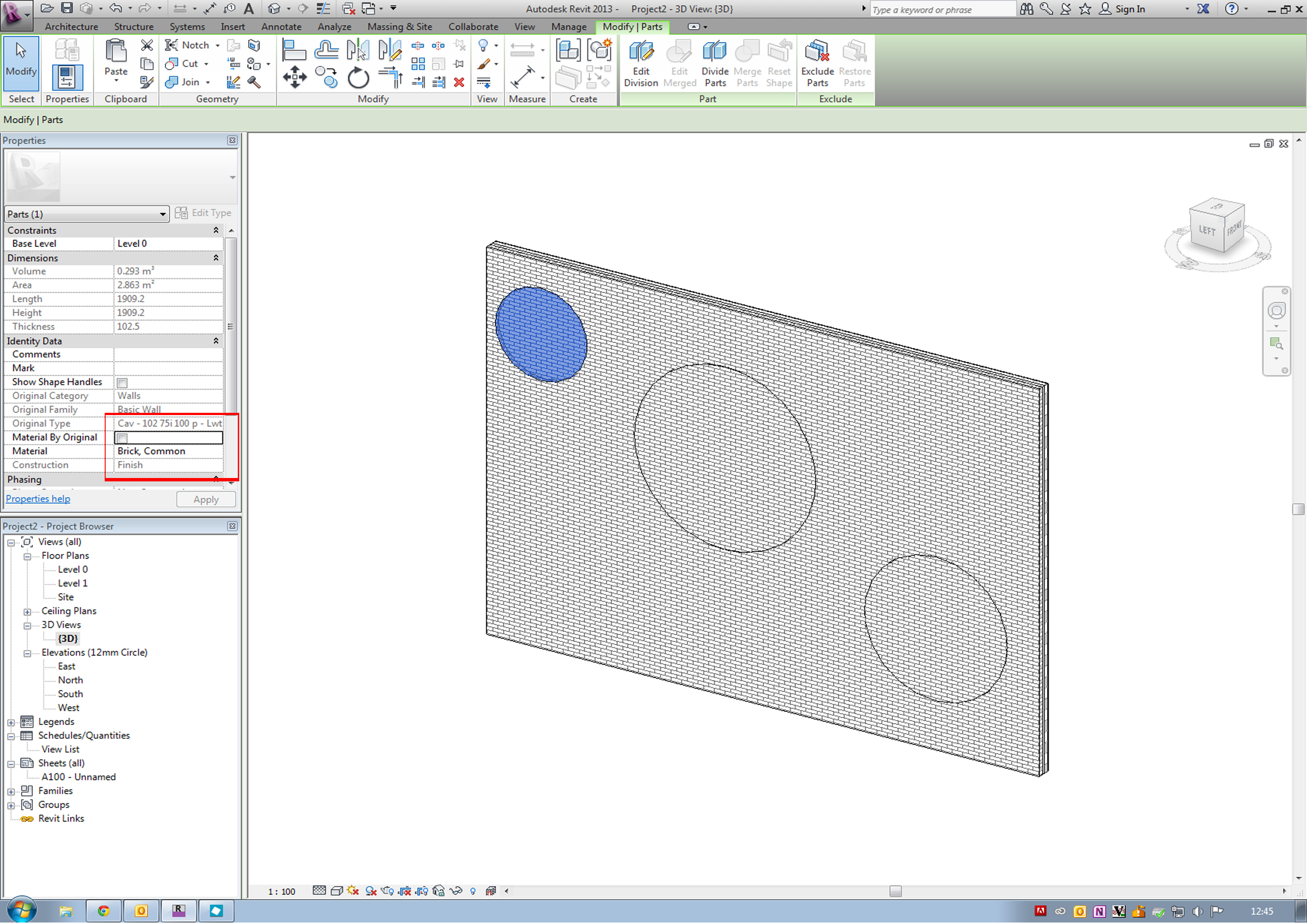

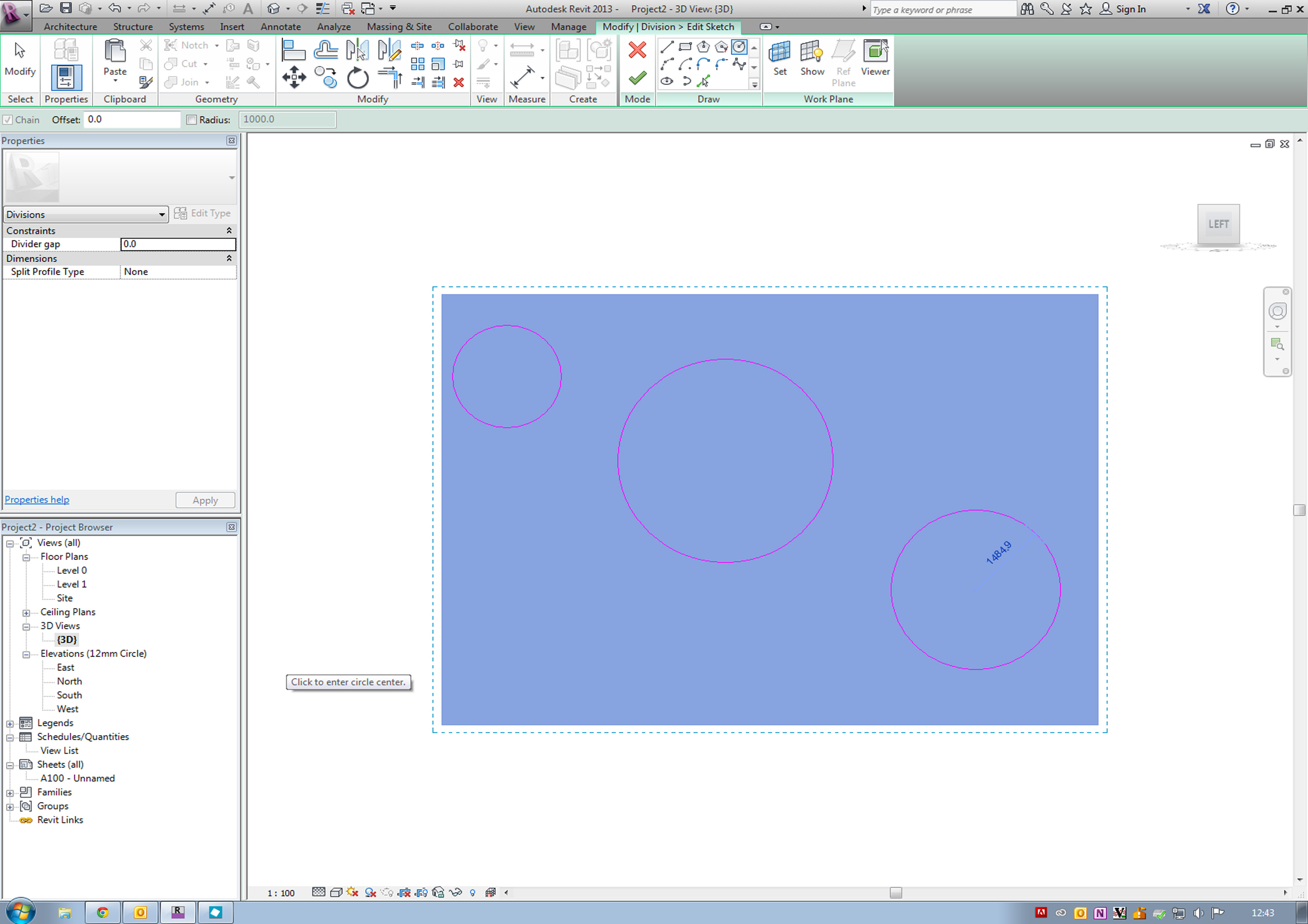

Or alternatively, you could give a single element multiply materials by creating parts, giving each part its own unique material.
As attached>>

Within your water texture, material browser, i did notice that you didnt have a surface pattern. If you change the surface pattern to solid, then your colour should appear.
This will only work with colours, getting material textures to appear in hidden line mode is another thing. I hanvt tried that yet!
