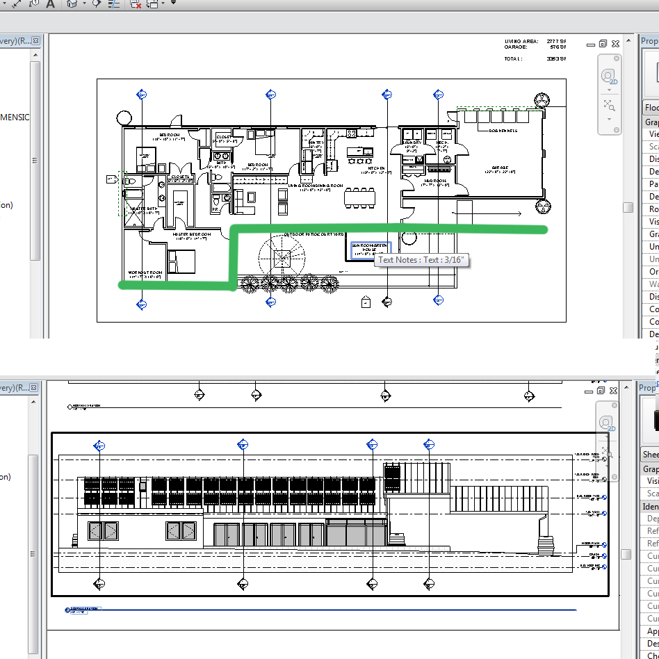

1. "Plan Region Equivalent" (See Photo)
- I would like to step back part of this elevation line...to only show the elevation of the building. Presently the line is beyond the exterior retaining wall (which includes a building wall). I would like to include the wall that has the sliding glass windows, as well as the wall that "juts out." Is it possible to step back the elevation line? or am I cursed to make two elevations and line-them-up. The thought of that makes me squemish.
Note: The greenline represents how I would like to show the elevation.

Do you want a split elevation segment?  Click on the elevation cut line and pick that option from the task bar.

WWHub: I was hoping to do a "step" in the elevation...from what it sounds like...you're directing me to do a Vertical View Break in the elevation? I imagine then I would have to do a second elevation, and move the line of that elevation in plan back towards the building correct?

It doesn't look like I can do what I need to do in 2013
http://ideatesolutions.blogspot.com/2013/04/new-elevation-line-functionality-in.html

Split elevation in 2013.... Use a section. that will split in 2013.  Hide the section marker and set an elevation that references other view and pick the section.
