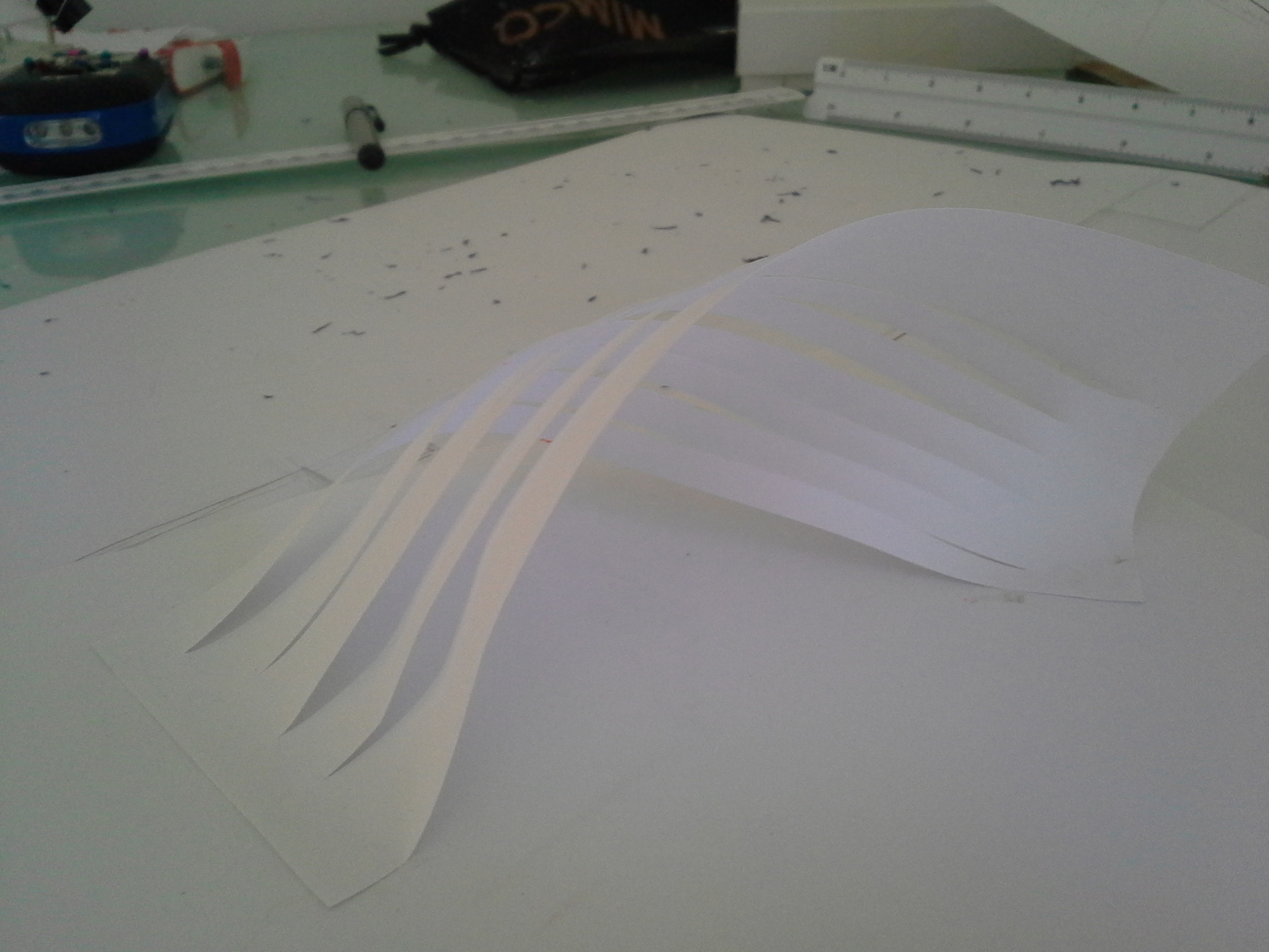

Hi Everyone,
Just wondering if anyone can provide any tips on how to model this roof in revit 2014. Ive tried to construct as a mass, but am finding it very difficult, especially the slits/openings.
Please see attached and thank you.
Ana

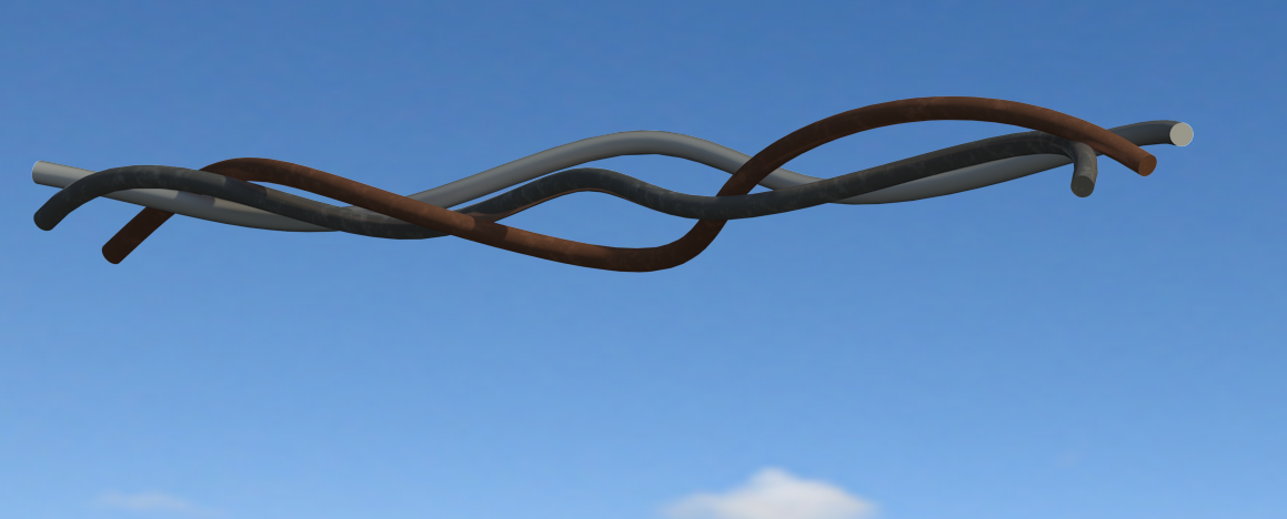

I'm going to say use an adaptive family. I created this family in about 5 minutes. The tubes are uniform but they didn't have to be, at all.
Edited on: Tue, Apr 29, 2014 at 9:44:07 AM
